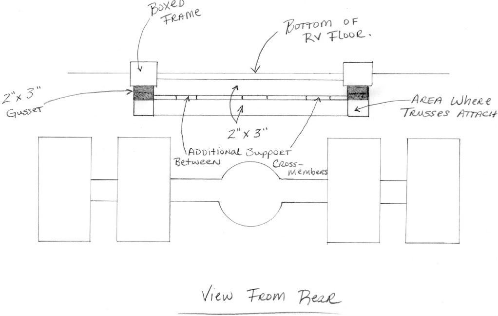

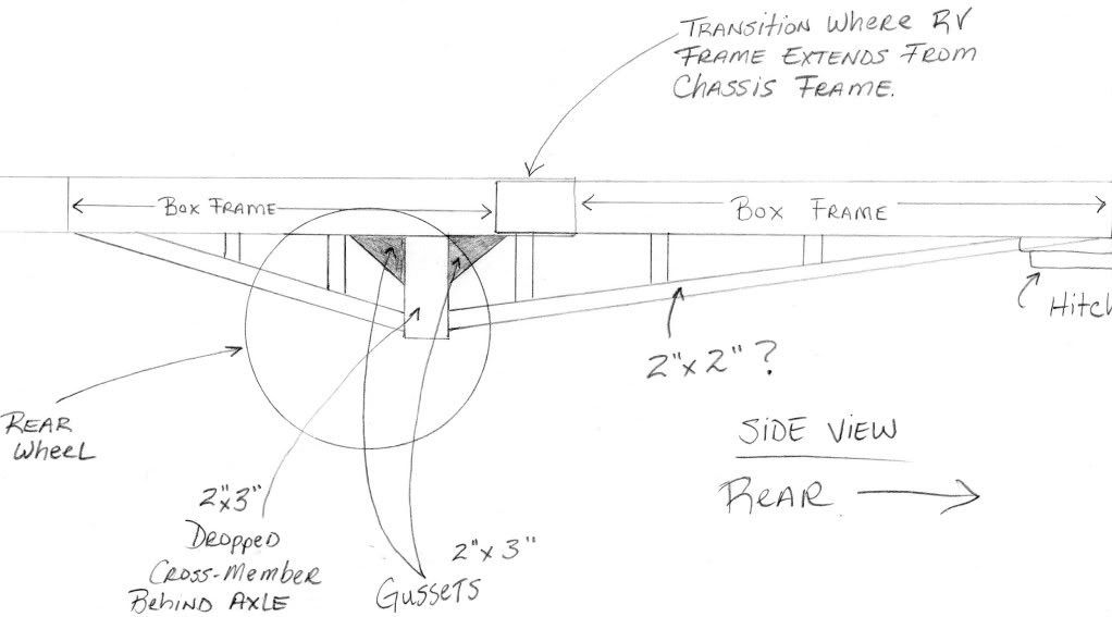

Post  Treeyasoon October 12th 2011, 5:17 pm
I just bought an '87 Winnebago Class A 3 weeks ago. It is in great shape with 65K on it and it was cheap. However, it damn sure isn't ready to pull an enclosed trailer as far as the frame goes. I looked at a Trailer Toad but, they want as much for one of those as I paid for the RV. My plan is to put some bracing in under the rear to tie things together. I can do that much cheaper than a Toad would cost and probably would have to brace it some, even with a Toad.
Here is my plan....feel free to speak up if you have ideas.

Post  69F100 October 12th 2011, 6:14 pm
Treeyasoon wrote:I just bought an '87 Winnebago Class A 3 weeks ago. It is in great shape with 65K on it and it was cheap. However, it damn sure isn't ready to pull an enclosed trailer as far as the frame goes. I looked at a Trailer Toad but, they want as much for one of those as I paid for the RV. My plan is to put some bracing in under the rear to tie things together. I can do that much cheaper than a Toad would cost and probably would have to brace it some, even with a Toad.
RV Tow Rig Img111
RV Tow Rig Img112
The bridge will work better if you use one long peace 2x2 and notch so you can bend it at the longest drop support and let that support weld to the top of the 2x2 then take some smaller tubing or flat bar and X brace in between the supports,a bridge support is only as strong as you build it.I would brace the frame good at the front of the bridge that is where the pressure will want to move to.

Post  res0rli9 October 13th 2011, 1:25 am
RV Tow Rig Img111
RV Tow Rig Img112
I would use 2x3 where you have the 2x2, make it all with 2x3 be much stronger. But that's just me Smile
