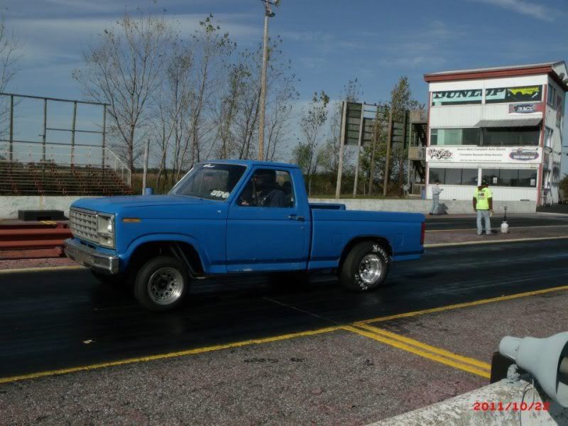

Dave I'm ok with how the day went. I got to make some passes with the increased air pressure.
Here is a picture of the truck from that day with 11.5psi in the slicks.
Does the slick look better or should I say ok in this pic?

f250mike wrote:Does the slick look better or should I say ok in this pic?
From that angle & lighting it is a little harder to see all of the slick's details. But it does appear to be "better" than before. It does look like the sidewall is wadding up more evenly an looks much less likely to be on the verge of running over it's own wrinkles like it was before.
The real question is was the 60ft/pass better or worse than before. As has been said a 1000 times before, every car/combo is different. So regardless of any suggestions anyone might make, if after testing a given car/combo was actually found to be faster with the so called "wrong" looking setup, the so called wrong setup is actually the "better" setup to use (for that given car/application).
