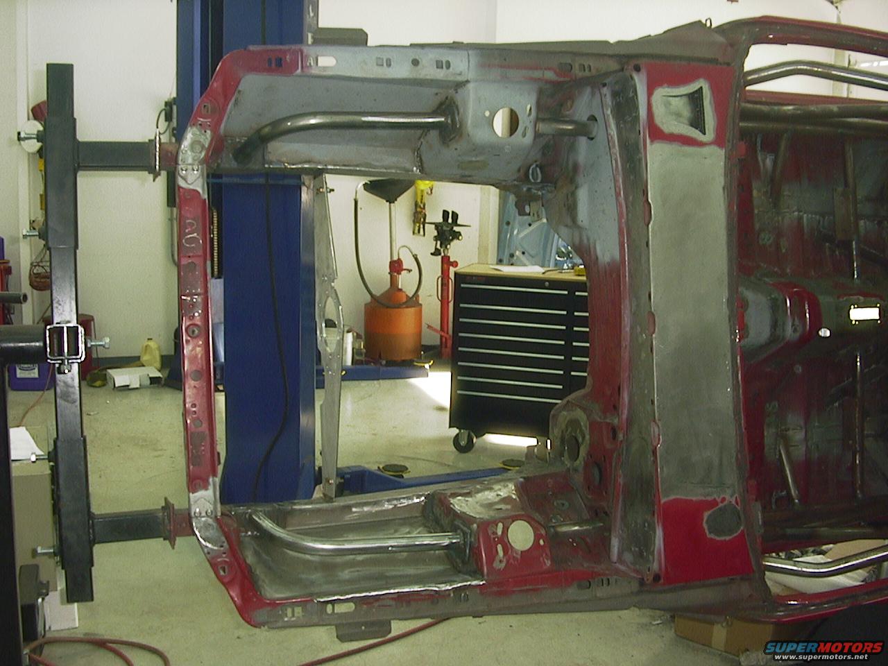

Here's are some photos of the one I built shortly after I finished building my shop. I had the Foxbody on it too.

I found one with the Foxbody on it and how I attached it to the rotisserie in the front, the back was same the same way using the bumper mounts.
