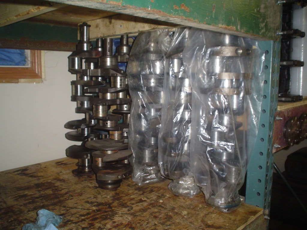

I have a few of those cranks too, as well as a few cast units. The nicest HD crank I have was also from a fire truck. It had only 15k miles, and was mint.
