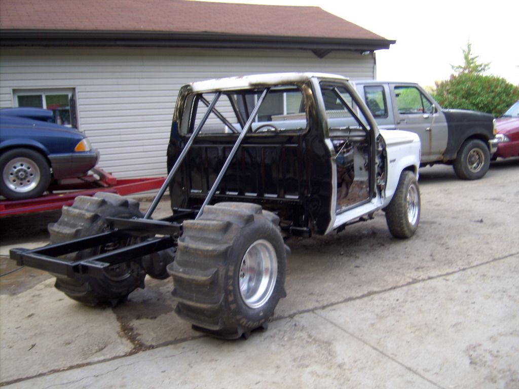

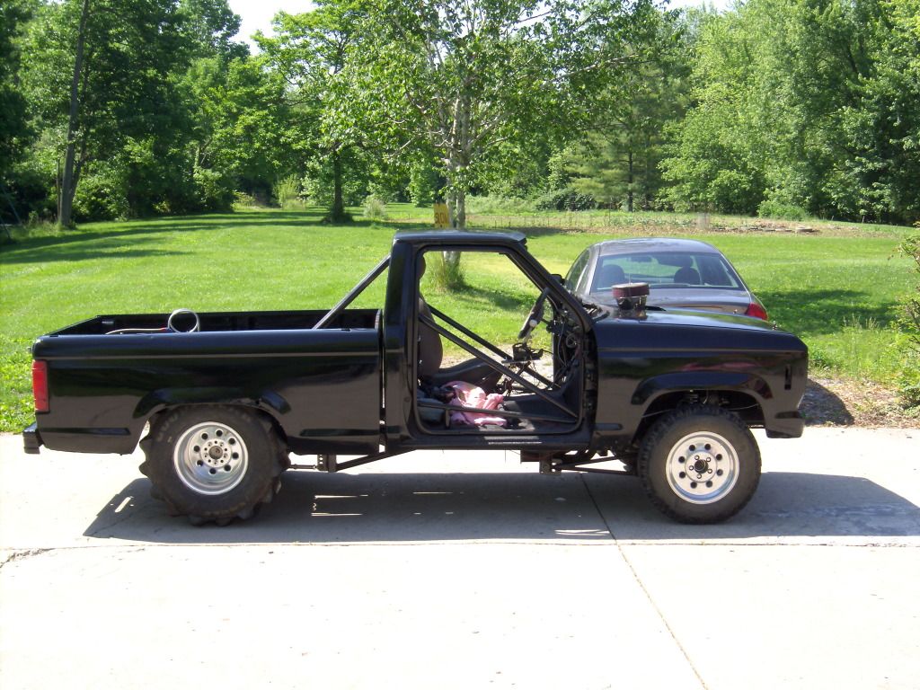

A front motor plate bolts to the front of the engine, I believe between the timing chain cover and the water pump. Then you can also use a mid-plate that goes between the engine and transmission heres a link to a front engine plate at Jegs. http://www.jegs.com/i/Competition+Engineering/247/4002/10002/-1
I just built a 84 ranger for 300 Ft sand drags. Its on a custom built box tubing frame, with homemade solid motor mounts, and a heavily modified firewall so I could move the engine back. It weighs 2950 with driver with 47% Front/53% rear weight distribution

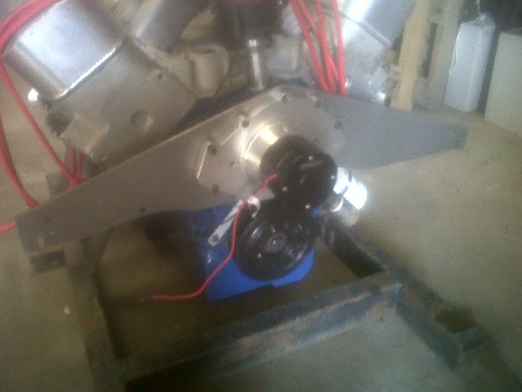

Post  schmitty July 5th 2012, 11:37 pm
Here is a pic of my front plate
NEED HELP! 83 ranger to 460 / c6 set up IMG00182-20110629-1852
I used the factory crossmember to hold the trans and T/C. Either way will work, the crossmember or a mid plate. Cool

Post  charchar1207 July 6th 2012, 8:31 pm
schmitty wrote:Here is a pic of my front plate
Where did you get your motor plates?
charchar1207
Posts : 31
Join date : 2012-06-29
NEED HELP! 83 ranger to 460 / c6 set up Empty Re: NEED HELP! 83 ranger to 460 / c6 set up
Post  schmitty July 6th 2012, 9:50 pm
I got that one from rmcomprandy here on the forum. He built that engine for me. It is steel and strong as an ox, and fit like a glove. It is made for a BBF in a fox body, but it works extremely well in my F150 chassis. Very reasonable price too. Cool
