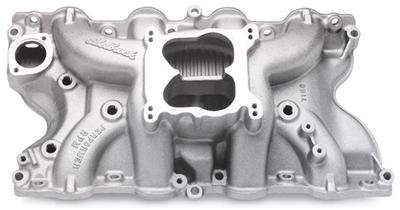

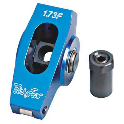

Post  norg on July 25th 2012, 8:42 am
so, concerning spec for 500-525HP of the topic http://www.429-460.com/t122-cylinder-head-info-gathered-by-djohagin
i can go with the next parts:
Holley 750 CFM Ultra Double Pumper™ Four Barrel Street/Strip Carburetor - Black™
EFI to carb conversion Large0-76750BK
Edelbrock 7166 - Edelbrock Performer RPM Intake Manifolds
EFI to carb conversion EDL-7166
Trick Flow® Roller Rocker Arms
EFI to carb conversion Tfs-53400621
Xtreme Energy™, XE274H Very Strong Mid-Range Torque and Throttle Response
EFI to carb conversion 12-246-3_600
for the heads... Is it possible stay with stock EFI heads or i need to fit TFS street heads with mild clean-up? Is TFS heads fit to my short block?
Thanks!

Post  dfree383 on July 25th 2012, 9:44 am
the rockers your showing will not work on your EFI heads with out modifing the for an adjustable valvetrain.
If you go with the TFS street heads it will make your goal much easier and you will not require the price adaptors. Yes the will bolt onto your short block.
Posts : 14246
EFI to carb conversion Empty Re: EFI to carb conversion
Post  rmcomprandy on July 25th 2012, 11:05 am
dfree383 wrote:the rockers your showing will not work on your EFI heads with out modifing the for an adjustable valvetrain.
