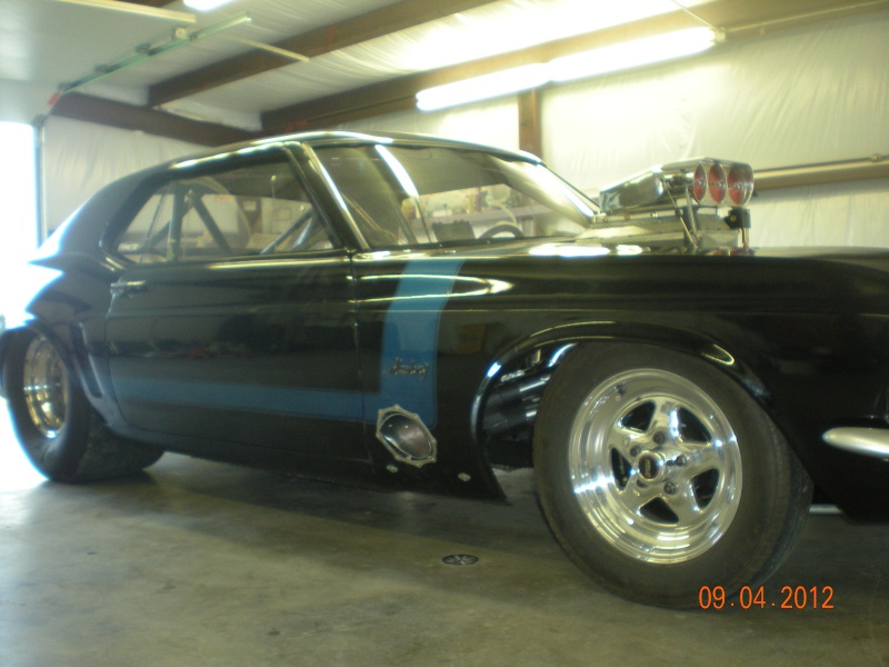

Post  cool40 on September 4th 2012, 10:32 pm
got the car back today! 2 3/8-2 1/2 out the fender bounce headers New_he10 headers New_he12
Posts : 7192

Post  cool40 on September 4th 2012, 10:43 pm
richter69 wrote:nice....... Smile
thnks,now i want to hear it!

Post  bbf-falcon on September 4th 2012, 11:04 pm
Looks great Lee. This thread actually comes at a good time,because i've been lookin around and doin some measureing the last couple weeks to do the same thing that you are doin. I've gotta get these methonal fumes away from me,that shit stinks. I'm hoping it'll make it a little quieter inside the car also. Where did you get your tubes and collectors at?
Posts : 8993
headers Empty Re: headers
Post  cool40 on September 4th 2012, 11:18 pm
bbf-falcon wrote:Looks great Lee. This thread actually comes at a good time,because i've been lookin around and doin some measureing the last couple weeks to do the same thing that you are doin. I've gotta get these methonal fumes away from me,that shit stinks. I'm hoping it'll make it a little quieter inside the car also. Where did you get your tubes and collectors at?
Rick i had a local guy build these for me.all the stuff is hooker but i dont know where he got it.the m5 fumes made my mind up about the fender exit. Laughing
