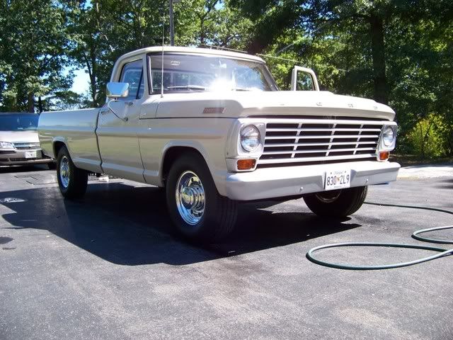

Post  TravisRice October 25th 2009, 8:10 am
How much crap to make a E4OD work behind a towing 460 based engine?? 049
Plans are for a FUEL MILAGE 514-545 pump gas low compression towing engine coupled with an E4OD or last resort an AOD.

Post  billandlori October 25th 2009, 12:11 pm
Thats goanna be an awesome tow vehicle Travis!!

Post  TorinoGT October 25th 2009, 2:21 pm
Wow thats a beautifull truck and a great project concept! Keep us posted with your progress!

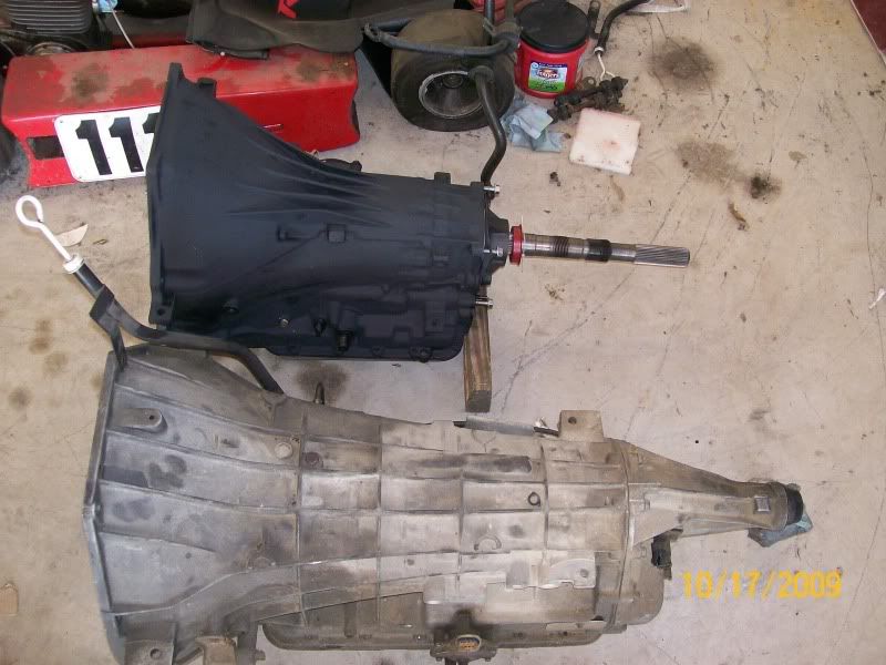

Post  Greg_P October 26th 2009, 8:24 pm
The E4OD trans you decide to use must be from a 460 engine, and it would be very helpful to be a 2wd model.
Also, there is no provision to drive a speedometer cable from the newer e4od's. The earlier ones, however, had a conventional gear driven speed sensor that will accept a speedo cable to run a mechanical speedo.
After giving it much thought, I have decided to go with the Baumann trans controller. Broader Performance is a dealer for the Baumann stuff, so check over there and see if Jay can give you a deal.
The converter I have for sale is a HD towing and RV unit with a forged cover. Supposedly it was installed along with this rebuilt trans and then the 460 in the truck tossed a rod.
The converter looks like new.
Greg
Here's a C6 and an E4OD side by side:

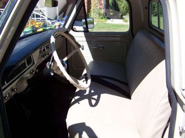

Post  OldRedFord October 28th 2009, 8:24 am
What I am wondering about is the transmission fitting. I think (I could be wrong here) that the transmission tunnel with the bolt on top is taller then the one that is part of the floor pan. Thought I would throw that out there.
Need a shot of the interior man. Shocked
OldRedFord
OldRedFord
Posts : 465
Age : 38
Location : Conyers GA
How much crap to make a E4OD work behind a towing 460 based engine?? Empty Re: How much crap to make a E4OD work behind a towing 460 based engine??
Post  TravisRice October 28th 2009, 5:23 pm
Mine is a original 4 speed truck, so it has the higher tunnel so to speak. right now it does have a C-6 in it.

Post  Nevs October 29th 2009, 6:30 am
TravisRice wrote:Mine is a original 4 speed truck, so it has the higher tunnel so to speak. right now it does have a C-6 in it.
How much crap to make a E4OD work behind a towing 460 based engine?? 043
Man that thing is clean. Nice unit. Cool
