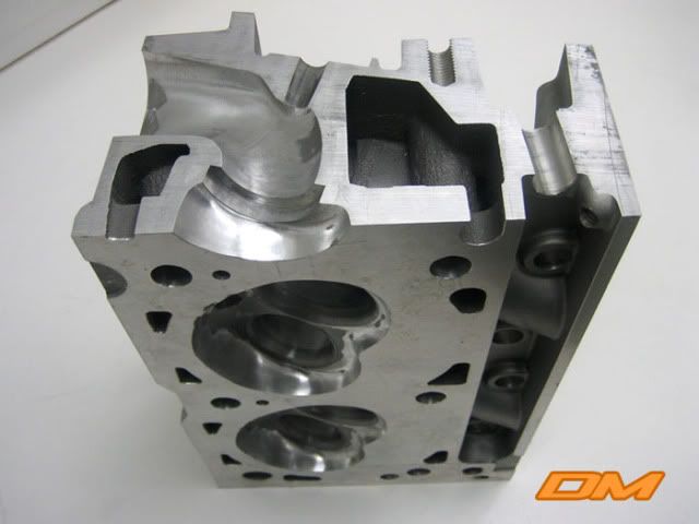

Post  bruno on November 3rd 2009, 6:03 am
here are some pics of the CNC version which sell for 749.99 each

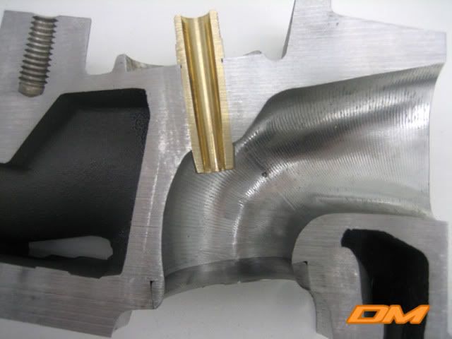

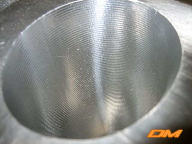

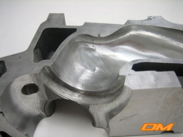

Re: PROCOMP HEADS ------ STICKY------
Post  bruno on November 3rd 2009, 6:16 am
here are some more pics of the head ...these were CNC ed by another company

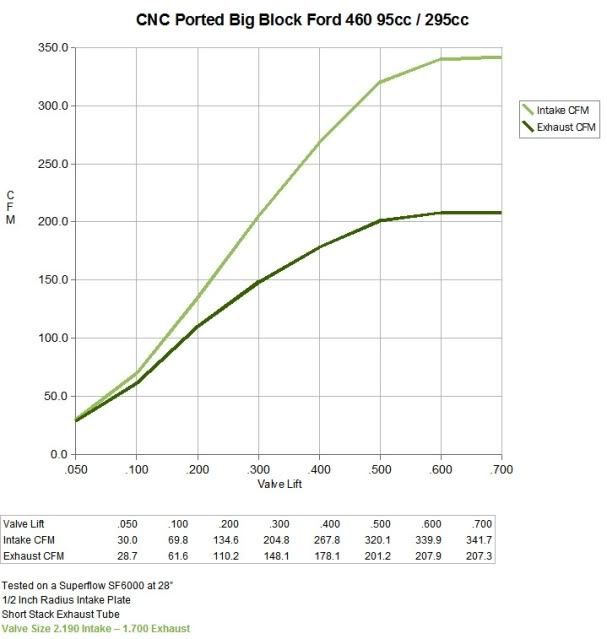

Post  bruno on November 3rd 2009, 6:26 pm
billandlori wrote:Some will say those are really good ProComp heads, they are cut up in pieces!!
How much cost does CNC porting add to the cost?
Out of the box flow #'s would be good to compare. Also if there is any piece to piece variations.
Bill
Bill here is what they say the out of box flow #s are
Post  dfree383 on November 3rd 2009, 6:32 pm
IMO they have their place, but overall I'd rather spend my hard earned money on something American and something of higher quality, better design and something that has better potential for the money spent.
Please verify the source and method of flow testing on those Bruno......
Post  rmcomprandy on November 3rd 2009, 8:44 pm
Bill
Aluminum Cylinder Heads
Intake Runner 300cc
Exhaust Runner 100cc
Combustion Chamber 95cc

Those flow numbers MAY be correct for a 300 cc port with a good valve job however, definately NOT "out of the box".
First of all, the intake runner without modification is about 270 cc's and max flow with a good valve job and an "out of the box" port is only anout 300 cfm on the intake side.
