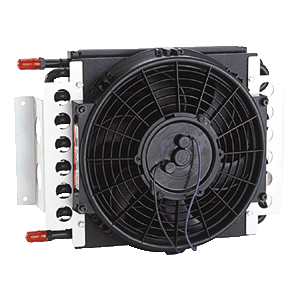

I have narrowed down the transmission cooler I want to go with. I am running a C6, manual shift, 3400-3700rpm stay that will be street driven. My question is what size line do I need? -6 or -8
Here is a link to the two coolers (25,000)
http://www.competitionproducts.com/Remote-Transmission-Coolers/products/1289/

For a street ride bigger the better.  They'll hold more volume

-6 is the normal size and IMO will do just fine

i use -6 also, the case is threaded 1/8inch.
I got 2, -6 maleX1/8inch male from Summit and made up my own cooling lines. A lot nicer having SS braided line to route away from heat, etc.
good luck!
