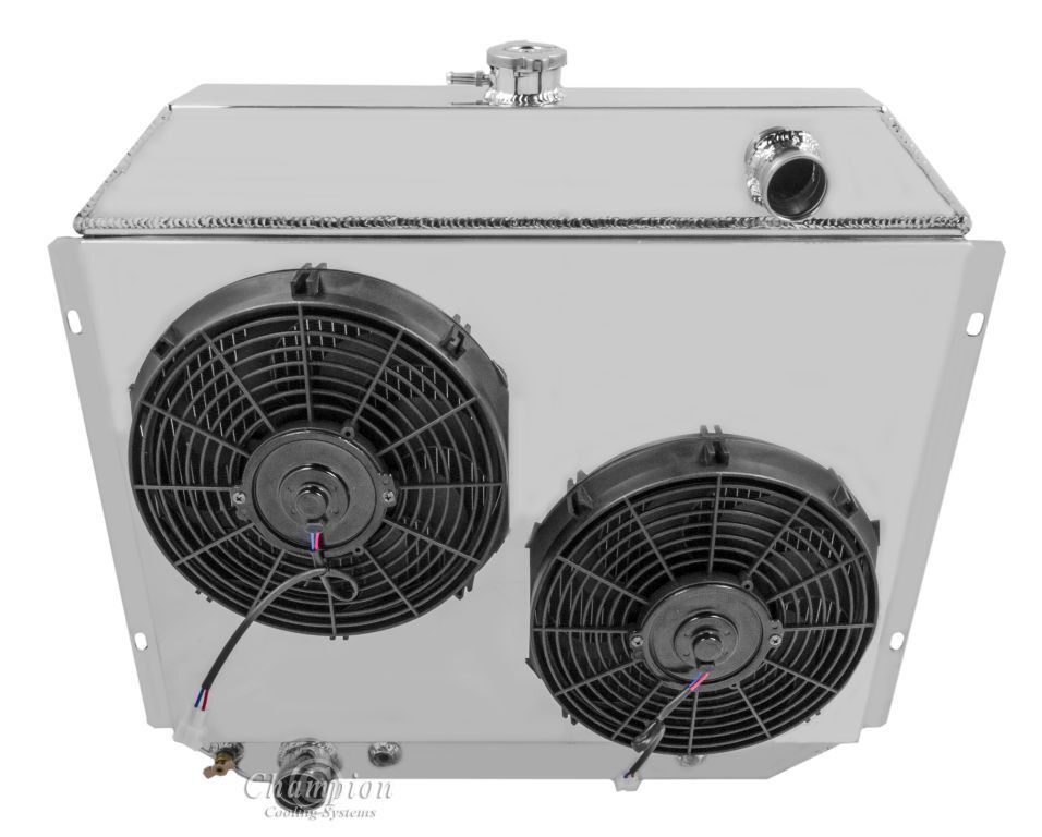

Post  FSU_Bronco on July 30th 2015, 10:15 pm
Would a Champion 4 row like this be a good solution?
Ford 460 overheating $_57
$440ish free shipping.
I do notice this unit comes with a 16psi radiator cap, and the one that comes with the bronco is 13 psi, however the bronco came with a 351m/400 and not a 460.

FSU_Bronco wrote:Would a Champion 4 row like this be a good solution?
At some point I still have to install an AC condenser in front of the radiator which will not help matters any.
Holy crap affraid Do you have room for that thing?? Behind the rear seat, maybe?

Post  FSU_Bronco on July 30th 2015, 11:37 pm
butterbean wrote:test your radiator cap, something as simple as that will do what you are describing
New Radiator Cap
I think it will fit:
Ford 460 overheating 20150730_231240_resized

supervel45 wrote:I went out and measured my superduty Modine out of the 78 F150. 28"W 30"T with a 4" thick top tank. The one the OP pictured looks more like the standard Ford truck radiator for those years.
I am almost positive the Bronco came from the factory is a 1 or 2 row radiator. I would be almost as positive that the one in it is factory and has had some repairs over the years.
The one in the picture claims to be 3 1/4 inch thick.

supervel45 wrote:
bbf-falcon wrote:The Fan is pulling and NOT pushing.right? Also,if you can find a Fan from a Mark viii Lincoln,that will cool that baby down.
         You posted before I hit enter. The Lincoln Mark VIII is a different animal, compared to what he has now.
Notice I said aftermarket. There a bunch of good electric fans from the factory. Taurus. Mark. Contour. Windstar. Etc
