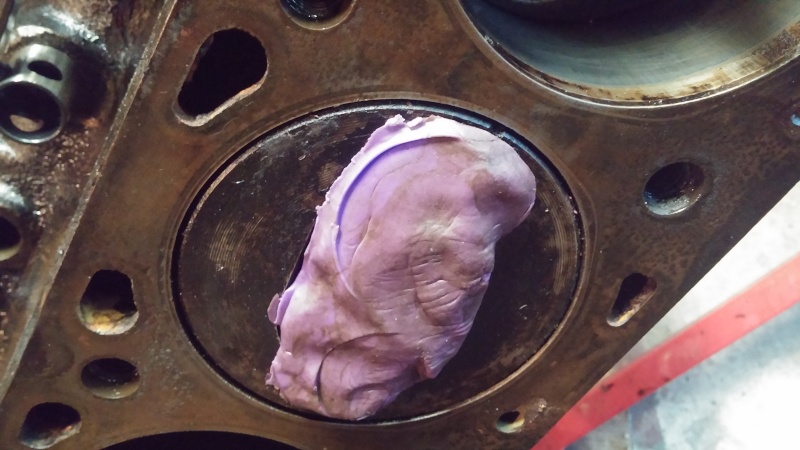

Just did a quick check with the bigger cam and it cleared. Couldn't find my dial (probably lost in my move)  so I eyeballed it with a tape and had about an eighth of an inch of clay. This was without a head gasket in there.
Seems like it should clear fine with a head gasket. Only problem was the springs were just about maxed out on both sides at max lift. I'll get a head gasket in and a cheap dial and run it again and measure to be as accurate as possible.

Scored some Lunati Cams 20160413
Scored some Lunati Cams 20160412
