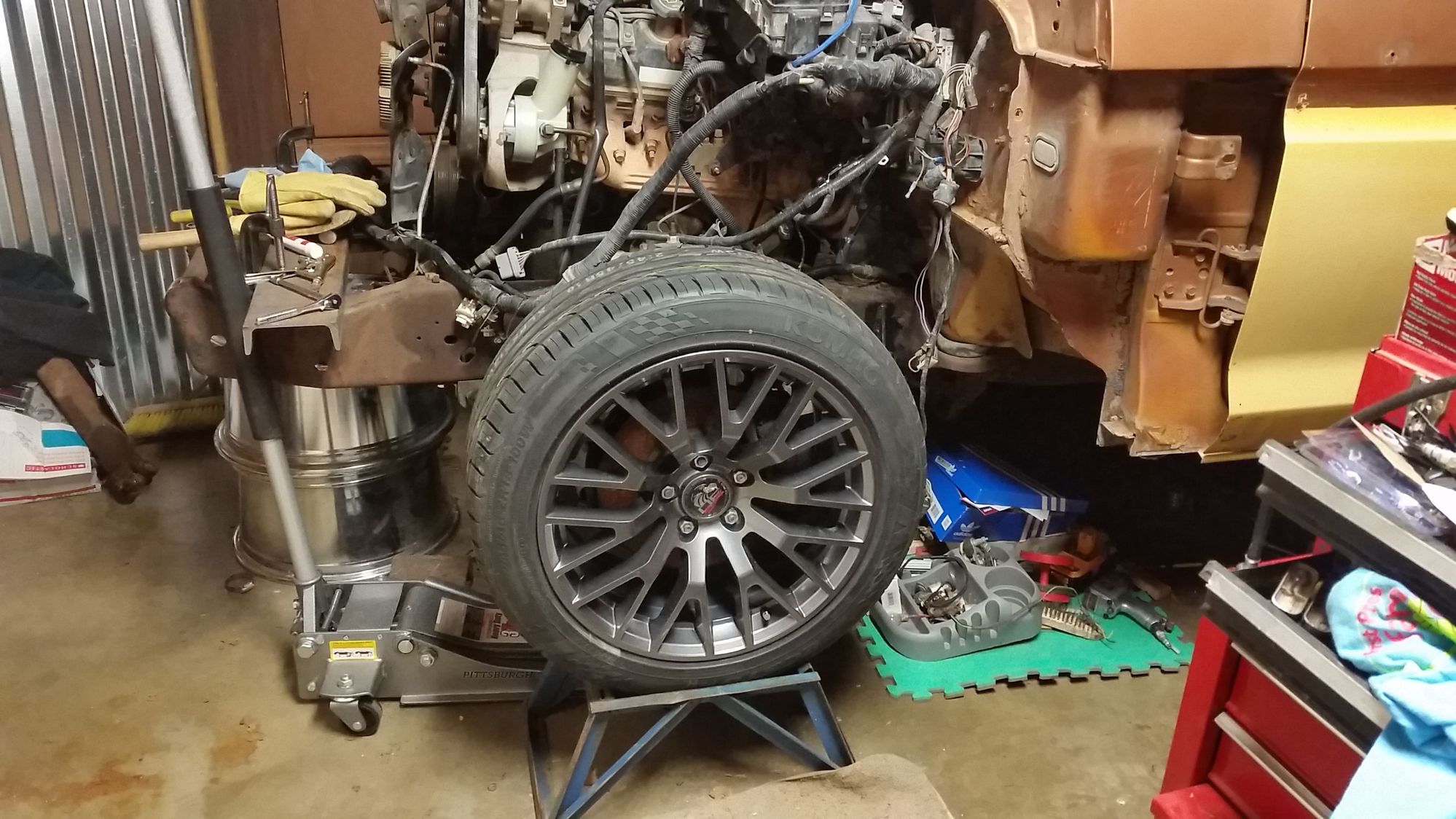

I have the back wheels off the Mustang so I decided to see how they looked on the pickup. It would need a different offset, but I think they look pretty good! Jake is more interested in 18" wheels though. Maybe he'll come around. Haha.

Front end is almost finished. Just need the steering shaft, so we went ahead and reinstalled the engine ans trans.
Slipped a 28/10.5 slick under the back for giggles.
Bouncing the front end up and down, I think this thing is gonna ride reeeeeeaaly nice. It is 6" lower in front and I think it will settle out even lower once the front sheetmetal is on.

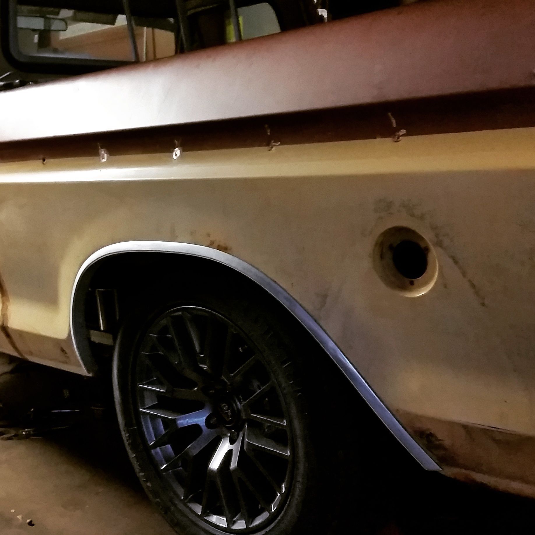

Got the tires mounted and balanced. I couldn't stand it and had to go bolt on at least a couple of them.
Front fit fine. Rears touch the inner fender well. I expected that they would. We had already planned to trim/mini-tub the wheel wells so everything will work right. Had we used a 9" from a dentside truck, we would have had plenty of room on the inside. But, outside edge room likely would have been really tight. The fender lip would have had to be trimmed considerably.

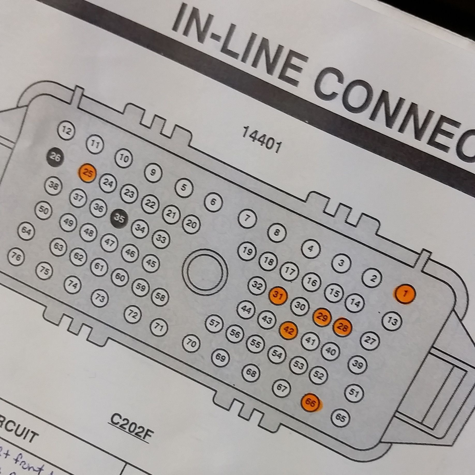

I compared the wiring diagrams last night and it is surprising how many wire colors are the same between the two.
The firewall connector has 76 wires. Of which, only 4 are necessary for it to run and 3 to report what it's doing (water temp, oil pressure, and tach).

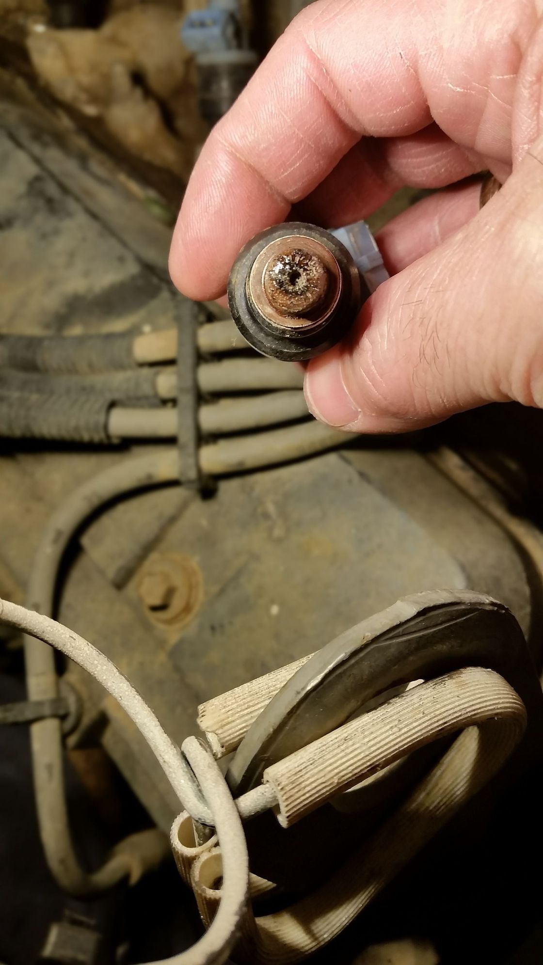

Cleaning the injectors was pretty easy. I took a tire valvestem, jammed it over the injector inlet, drilled a tiny hole in the cap, poked the red carb cleaner straw through, pressurized the injector and cycled it with a 12v source until it sprayed a nice pattern. Worked awesome.
Chawed injector o-rings. There were a lot! Glad we decided to R&R them!

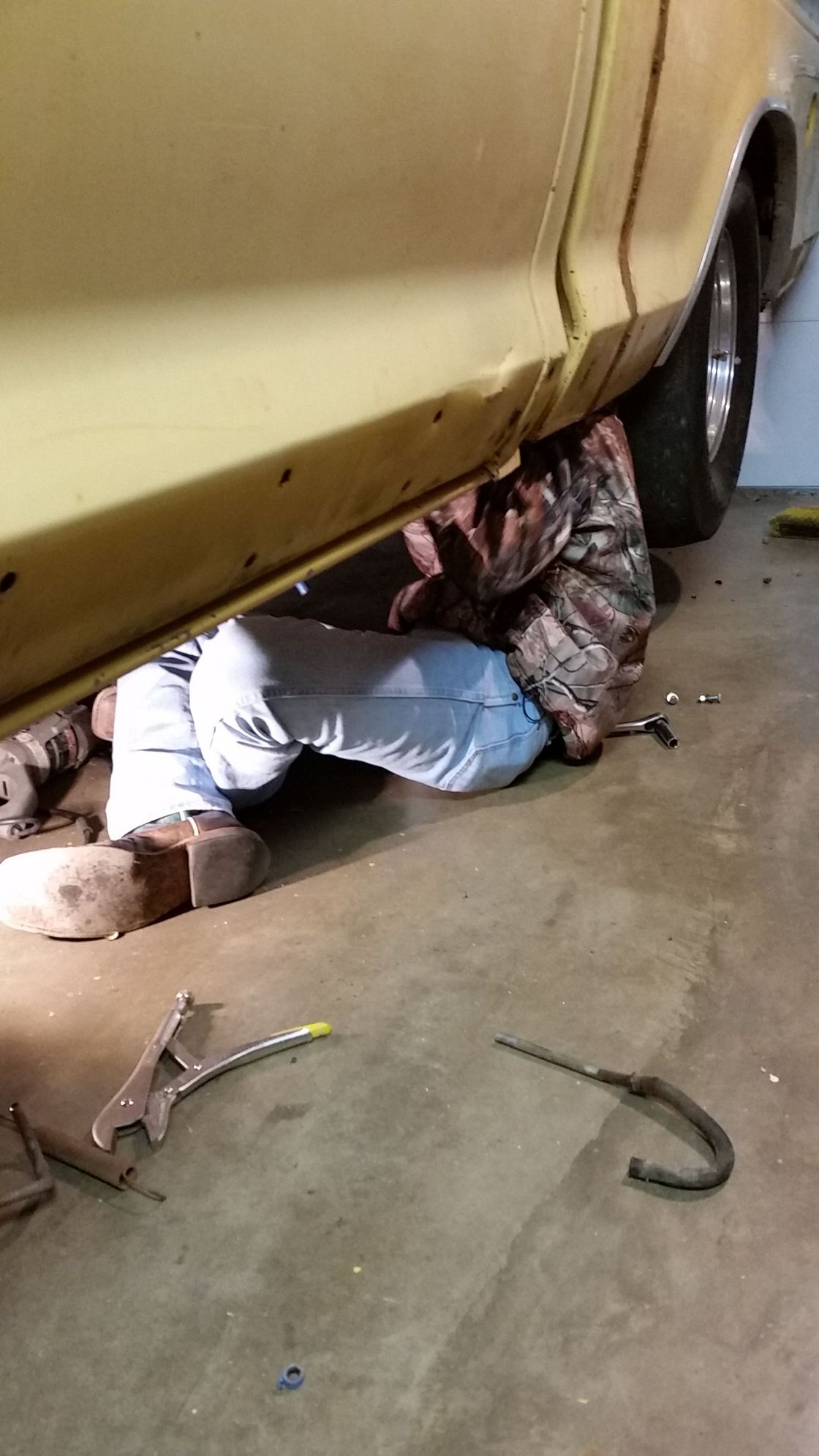

- new brake pads and new driver's side caliper installed (old one was chewed up from not having a brake pad in it)
- inner bed fenders cut out for tire clearance - mini-tubs
Jake putting the finishing touches on the brakes.
