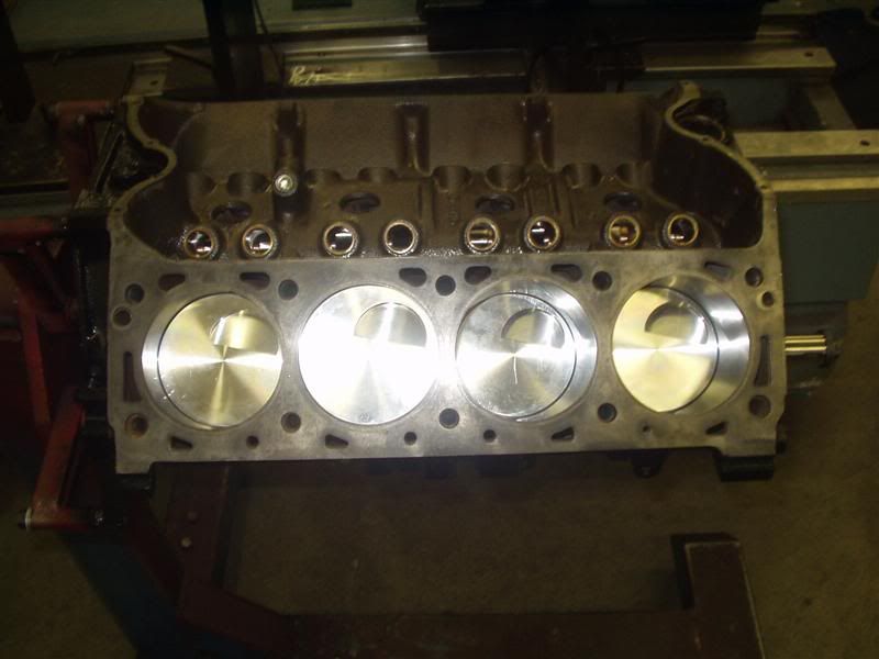

Post  Lem Evans on November 5th 2016, 12:23 pm
"I have had them on 4.400 to a 4.600 and didn't affect the flow, I would suspect the valve moved so far of the cylinder wall is why."
Yep, that SCJ/P51 intake valve is waay off the cyl. wall.....this is only a 4.400" bore:
