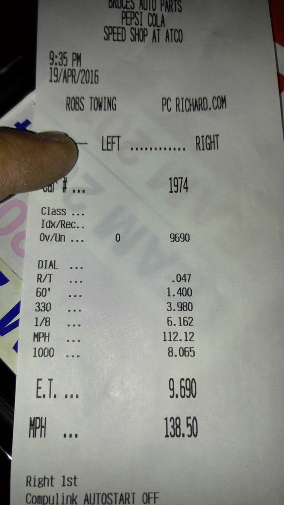

I have a 2005 Mustang GT and put a glide in it with the supercharged mod motor it had before (trans specialties, 1.80 straight cut gears and originally the 300M input shaft which broke.  Changed to their Nasa shaft and haven't had a problem since).  That setup made great torque with the TVS supercharger and weighed in around 3700 with driver.  Switched to a 521 BBF carburated last winter and kept the glide and it's still been flawless.  Using a trans specialties Super 8 converter which is a 9" converter which stalls around 5100.  Car has been 9.69 and still weighs around 3700 with driver.
28" tall micket thompson pro bracket radials that hook on just about anything, 4.10 gears and I usually keep the engine restricted to run 10.0 range going through the finish line just shy of 7k rpms.  Running 9.69 it goes through around 7300 rpms.
After re-reading your post I guess you run 1/8 mile talking 6.70's. I run 1/4 mile and here is a copy of the 9.69 slip so you can see the incrementals.
Anyone run a heavy car  (3700) W/DR. with a Powerglide with a decent torque motor 528? 0419162127_zpsxfa4xcf5
Last edited by dysan on December 18th 2016, 7:14 pm; edited 1 time in total (Reason for editing : Added time slip)
