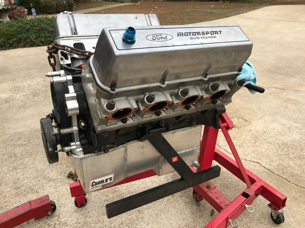

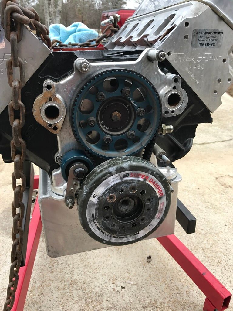

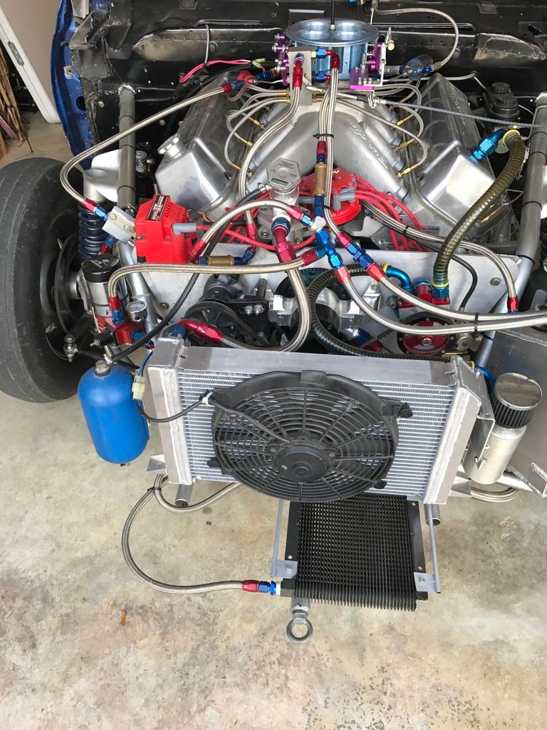

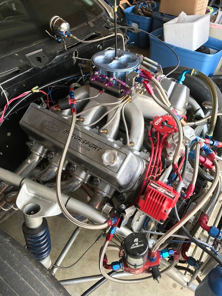

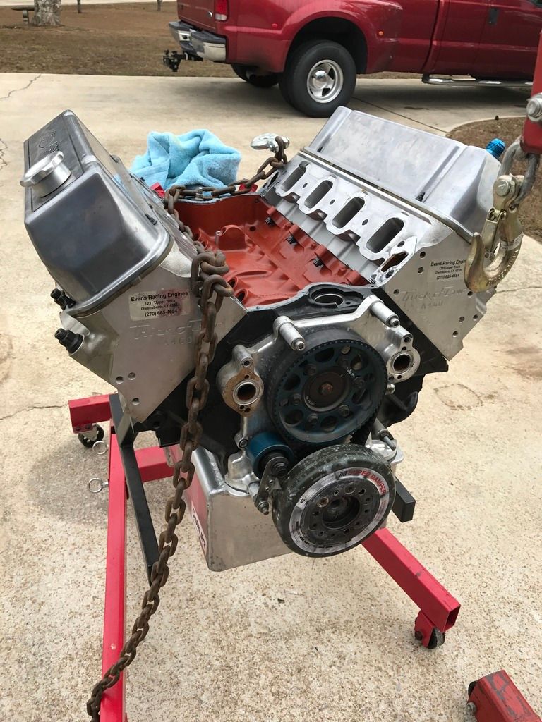

Time to give the T-bird a physical, or at least a trip to the heart doc to check on the ol ticker.
fully dressed:
Time for a physical 65C4BDE8-AF1D-47D9-BF9A-BD7349277F1A_1
Time for a physical 8285C41B-77EA-4045-81FD-8B5F67C9EA77_1
Not even a a hospital gown to cover up lol
Time for a physical B88EF80F-3CA4-4AE8-BB5C-F51F50F392AC
Time for a physical E7B621B0-AAD3-469D-8D98-0C895B7E1B21
Time for a physical 136EA856-A54D-41A3-B92C-79D4B0D2FD86
Lifters out to be rebuilt (Morel), getting new valve springs and a new Danny Bee belt.  Shop will check the bearings and replace unless thy look brand new.  Going to a run a leakdown test before pulling the heads to check ring sealing.  I think they are most likely ok as it runs the same as it always has.  If it needs rings then it'll be done as well.  Just a little insurance.  Pay a little now for piece of mind rather than run it too long and take a $$$$ risk.

They can work on most anything from Flatheads to BBF to 426 Hemi. It's mostly chevy just because that's the market in the area. They gotta eat lol. I was over there today and Rick was showing my a new build on a blown up 5.8L 13-14 GT500 engine. Wasn't much usable from the previous engiine. Previous one had ruined the block when a rod broke from a combination of rpm, boost and a canned "internet" tune. Also told me about a stock block P-51 head 557 they did not long ago that made over 900 hp.
He just did a leakdown on my 598. The rings are still in good shape. 7 were in the 6-8% range with one falling at 12%. The one higher may be to just a cold engine or ring gaps lining up with the low tension rings. Next is a tear down to check the bearings. Going to replace the bearings, rod bolts, valve springs and Danny Bee belt/seals.
