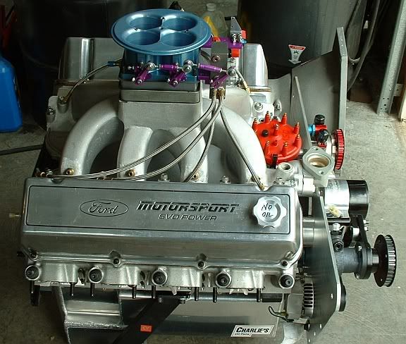

My passenger side valve cover is drilled/tapped for a 1/8" barb fitting on the rear facing the firewall.  We set the vac on the dyno and I check it from time to time with a hand held gauge and it always has read the same.  I do clean the inside of the pump at every opil change with about 1/2 a can of carb cleaner into it with the engine running.  No gauge in the car but I do have a logger with an open channel.   I plan to get a vac sensor and hook it up.  Just never got around to it yet.
Mounted the pump to the plate.  Took a little doing, but I set the pump at distance from the mandrel so it uses the same belt as the fuel pump.  Only need 1 spare in the trailer.  I just added a pulley to the Ron's crank mandrel to drive it.  Same tooth pulley as the fuel pump.  Also, since I run a Boss 9 short crank snout I had to shorten the mounting stand for the vac pump to being it right against the motor plate or else it stuck out too far for the pulley setup to align.
Ron's fuel vacuum pump 598bbf
In this pic you can see the barb fitting on the back of the valve cover.
