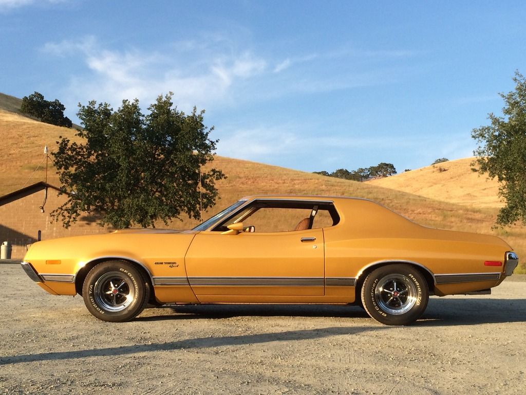

Thanks to all for your helpful comments. I'm going to run the stock flex plate in this cruiser application.
