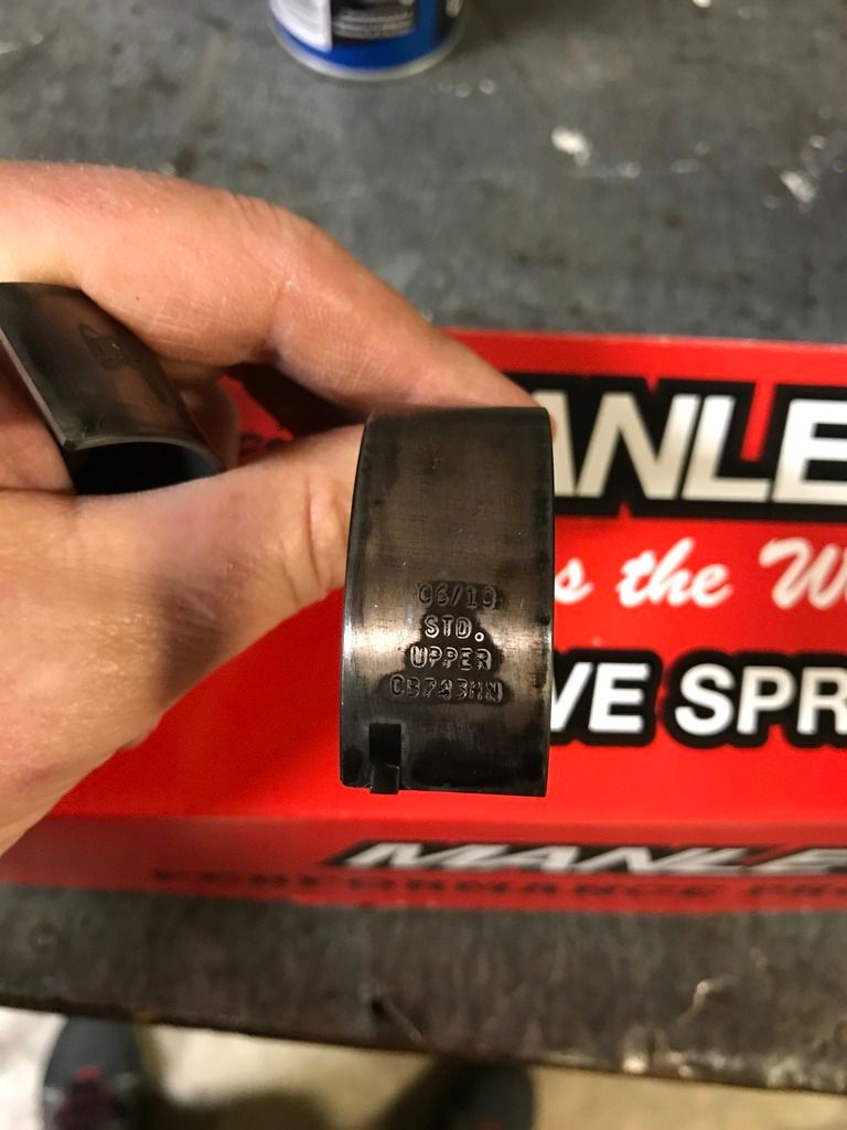

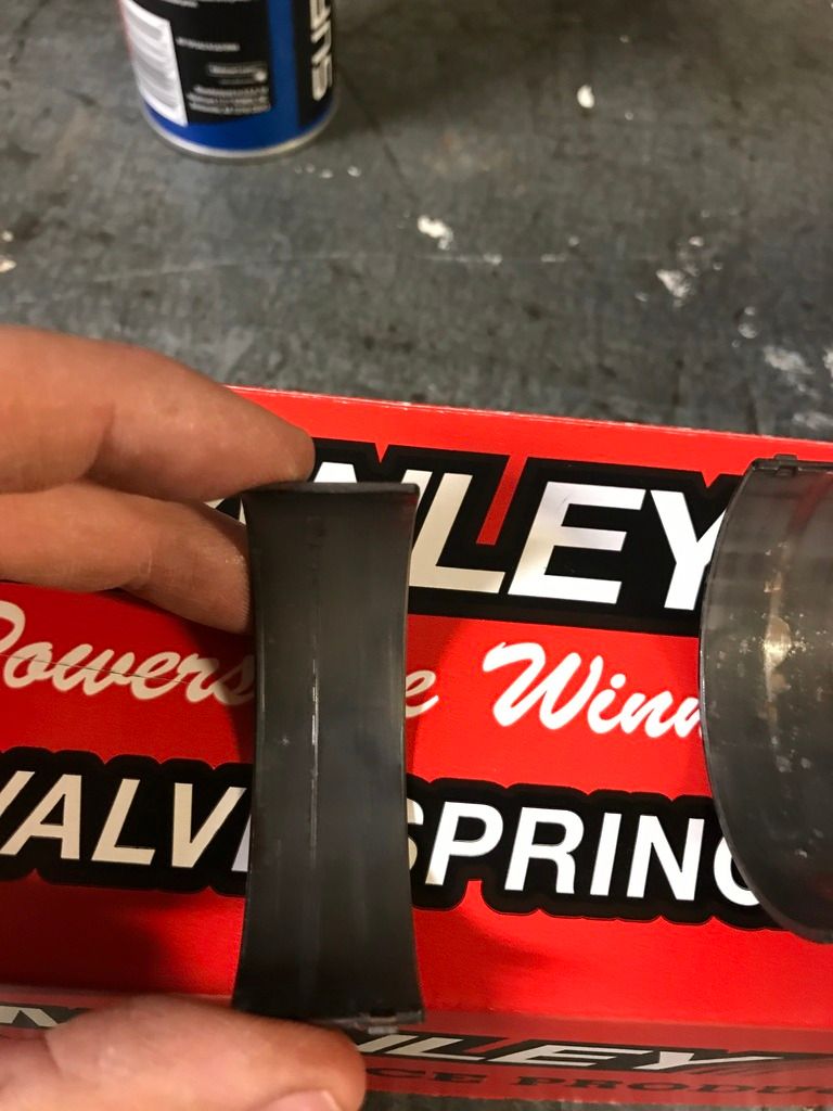

The best thing was the bearings.  Alky burning engines tend to be pretty rough on bearings.  Mine were in great shape.  Replaced 2 upper rod bearing halves.  That's it.  All the mains and rod bearings still had the marks on them from the mic when he measured and installed them 5 years ago.  They were perfect, so they went right back in.  Not a mark on them!  The two upper halves that got replaced were due to a piece of trash getting to them.  One had a scratch/streak you could just feel.  The had some shiny spots that you could flake off with a thumbnail. Under the spots/flakes were untouched bearing surface.  These where a tiny piece of aluminum from somewhere that got in there and was squashed super thin.  Didn't hurt the crank at all.

The only bearings that were replaced.  Again, the others were prefect.
