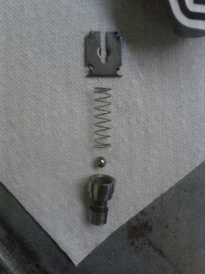

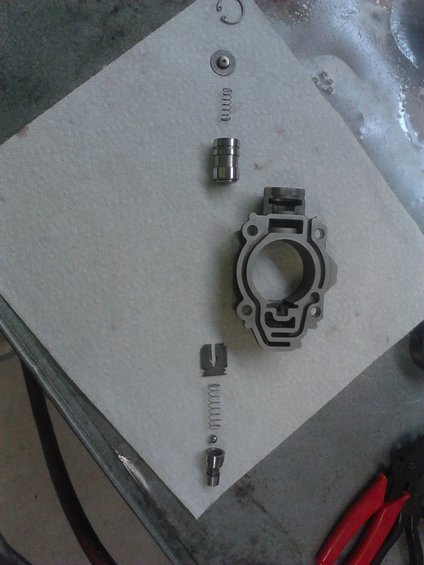

Post  aquartlow Fri 2 Jun 2017 - 21:24
Gregaust wrote:Was a post here recently with a 1/4 ball added to the governor . I can't find it right now
Greg,
Not sure if I was the "culprit" who posted the 1/4" check ball, but this is what I found when I opened up my governor:
 c-6 governor mods P82a0441
 c-6 governor mods P82a0442
Hope this helps.

Post  Gregaust Sat 3 Jun 2017 - 0:52
Greg,
Hope this helps.
That's the one . I did save the pics , found it very interesting. Would like to see what the difference is here with that mod
Gregaust
Posts : 613
 c-6 governor mods Empty Re: c-6 governor mods
Post  aquartlow Sat 3 Jun 2017 - 7:08
I read/researched that stated lightening one of the valves raises WOT shift point, when I opened my factory governor I found the check ball inside(I have also seen this in just a few [read very few] other pics floating around the internet showing the same factory installed check ball), I didn't have any tooling to lighten the valve so I just removed the CB instead and re-installed governor. Doing this raised WOT shift point from around 4400-4500 rpm to just over 5100 rpm and the CB removal also seemed to help with a down shift(like coming to a stop sign/traffic light) harshness my trans was experiencing. This thread may help, at least the pics showing the differences in the valves:
