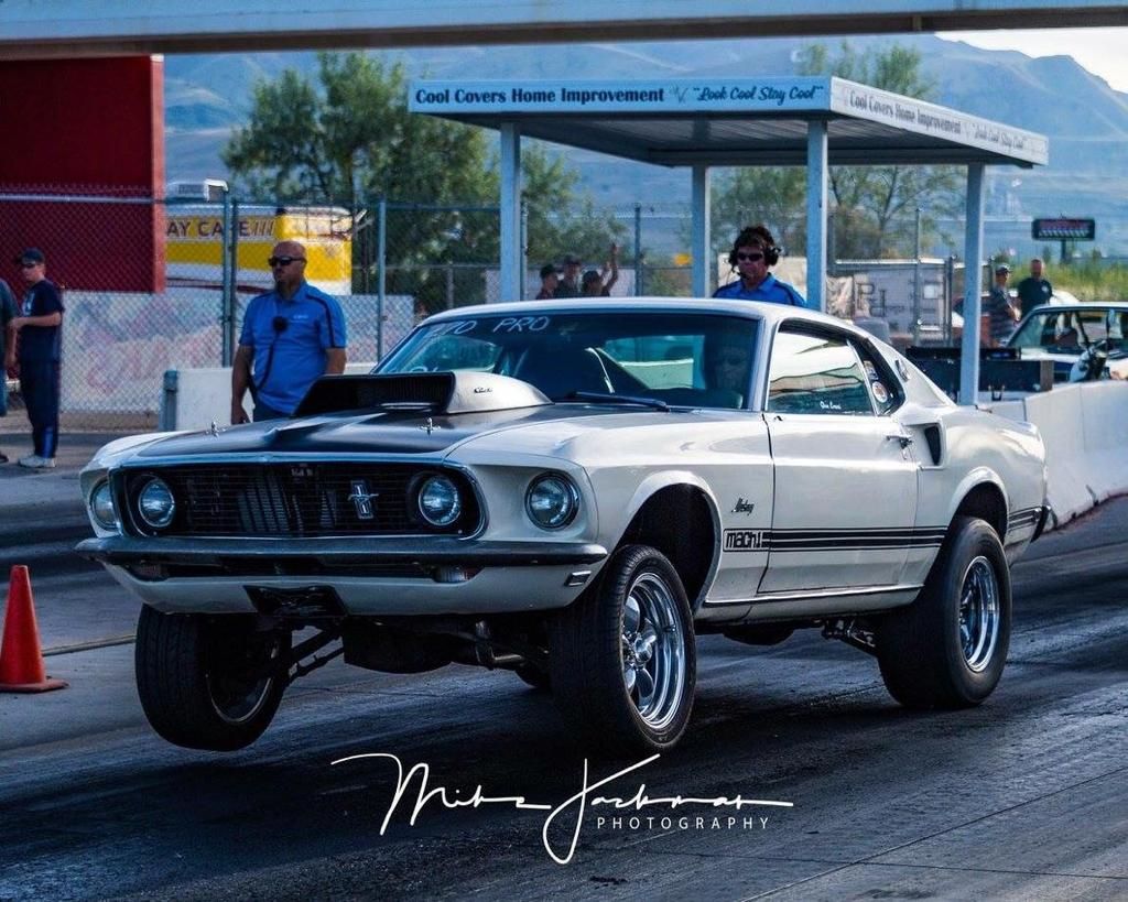

Finally got the new motor running! IMG950275_zpsxryjvxgghttps://2img.net/h/i1275.photobucket.com/albums/y446/glen975/IMG950275_zpsxryjvxgg.jpg

Post  Mark Miller June 20th 2017, 11:12 pm
glenevans wrote:Finally got the new motor running! IMG950275_zpsxryjvxgghttps://2img.net/h/i1275.photobucket.com/albums/y446/glen975/IMG950275_zpsxryjvxgg.jpg
Cool looking car and nice wheels up launch!!! Smile Smile
