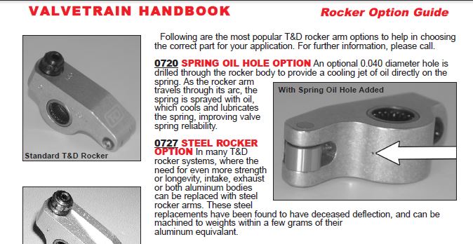

Steel rockers for sure. The aluminum ones are well known to break.
Maybe some spring squirters to keep the springs cool on the drives. Drag Week eats springs.

BigBlockRanger wrote:Steel rockers for sure.  The aluminum ones are well known to break.
x2
From T&D's catalogue:
Getting engine ready for Drag week 2018.  Captur10
