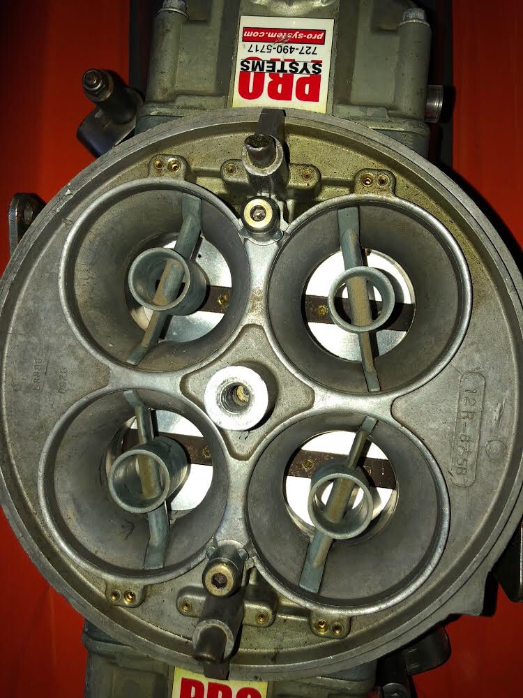

So after the other night and the car not running right, I think I have something wrong with the carb. It's a race gas 1050  Holley L8896 which is an old carb and supposedly different compared to the 8896. I sent pics to Patrick at Pro Systems and he said that the boosters in it won't ever work well and also the carb body being as old as it is, would not work well with one of his electric pumps and vacuum regulators and bypass.  Never have heard that's before, but it sure as heck didn't work the other night Sad.
I also have a 6464 carb that I could probably use, but it seems to also be very old tech and not meant for a true racecar.  Would I be best to send the carb off and just go ahead and change it over to alcohol, or do you think I can get one of these to run on race gas? Any help would be appreciated.

Sorry phil, i thought i had added it, but this carb isnt one of his Sad When i traded for a motor it had this carb with it and someone had taken his bowls and put them on this carb. When I first sent pics to Patrick when I first got it, he told me it wasnt one of his and it also doesnt have is numbers added to the body of the carb. He told me months ago that the carb wouldnt work with an electric pump and bypass and that also the boosters in the carb dont work and thats why he uses annular boosters in everything he builds. I didn't listen to him and took the dragster out Saturday night and after about 330 or 400 ft the car would spit and sputter and pretty much die needing gas. The fuel system is completely new, I got a steal from an old pro stock guy with a weldon fuel pump along with bypass and regulator and Jim Craig told me although its a little overkill, this combo has worked on motors like mine plenty of times and sent me exactly how to set it up properly and tune the system. The carb has 50pump, 37 squirters, dogleg boosters and 94 jets square in it and the floats seem to be completely fine, it's just a pretty old carb and isnt one of the new HP bodies with the Holley dom's now. So now I am wondering if I should try and send this out and pay a small fortune to get it tuned, but still have an old carb, or buy a newer HP or Quick Fuel model and use that and try and get it to what I need myself because it seems this one is way out in left field. As far as Rupert, that is all we have ever ran, but I kind of wanted to stick with race gas in this motor instead of alcohol, but I guess if i am going to spend a fortune on a carb I will most likely just get it changed over to alcohol and be done with it.

It probably needs the larger .120" high flow needle and seat assembly. Sounds like the bowls are running dry and the small needle and seat cannot fill the bowls fast enough for recovery.
