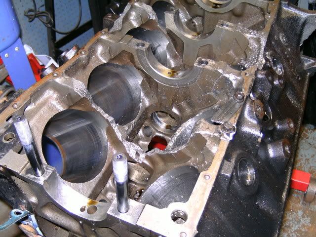

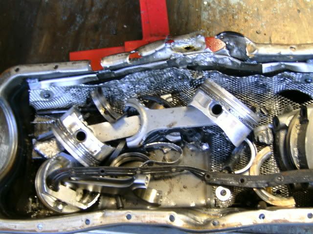

Post  Larry T on August 26th 2010, 8:17 pm
in your own words:a picture is worth a thousand words.........well here is 2 pictures + a few words 838hp/732tk it didnt last long. Rolling Eyes
