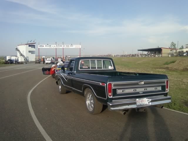

Gee, only took 9 replies to get my thread back! Haha, yes Mark, we will have to meet up soon. Thanks for the recomends on the cam, looking for something not too choppy, and I don't want to grind valve reliefs. There's no machine shops around here that will do the multi-angle, so I would have to do it myself. Did a set 20 years ago and I still remember the grunt work. I wasn't sure what the comp ratio would be, thought it would be higher, forgot about the 10.33 deck height...9.2 would be perfect. The truck has dual tanks, and I'll be running farm fuel in the one, and premium in the other. I'll just switch tanks when I pull into Redcliff.
I don't have Dove heads, I have some C9's, same difference except for the bigger spark plugs. These things have studs (positive stop) and guide plates...ahhh, the good old days when passenger car heads mattered! I've been watching the for sale sections here and at Chilly's for some ready to run Dove's, but any I've found were too far away. Thought it might be cheaper to get some ready to run than pay the high machine shop costs up in the great white north.
Here's a pic of the truck, it's an e-bay find out of Sacramento.
[img]
[/img]
The 20 inch rims and tires have been replaced with normal, "American" stuff lol
[img]
[/img]The 20 inch rims and tires have been replaced with normal, "American" stuff lol
