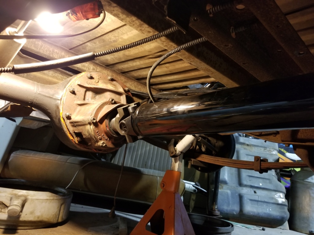

Post  BigBlockRanger July 10th 2020, 2:47 pm
Diff is swapped, driveshaft is in, just have a list of about 5 little things I need to do before I set it on the ground and take it for a test drive in the parking lot.
