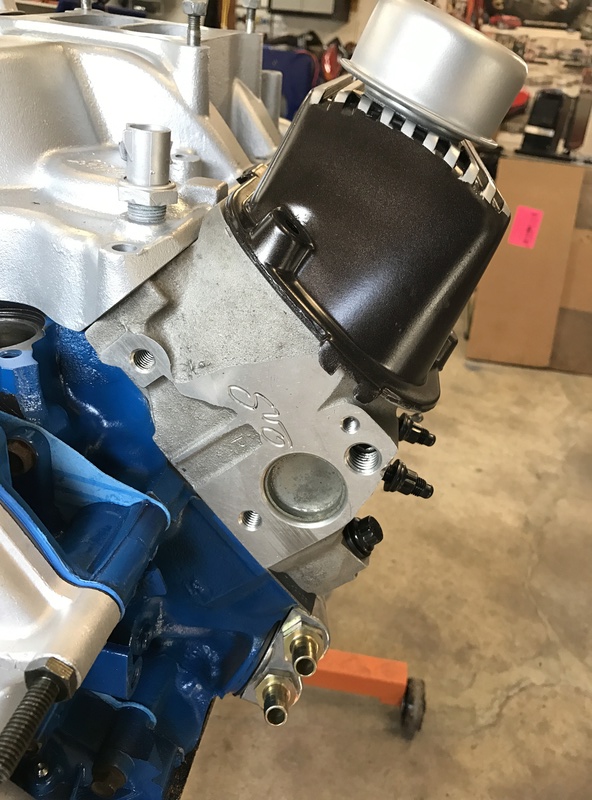

Putting a 302 together and noticed that one of the accessory bolt holes is smaller then the other 2. Can I just drill and tap it to match the other 2? I need them all the same to bolt the oem accessory brackets on.

You do realize that one side of the head has different sizes than the other side, correct ?

I looked at both ends and they both seemed to have the same 1 different than the others, but I will look again tonight. If I was wrong, then I'll pull the heads and flip with new head gaskets. Would be just my luck if I did them wrong.

Ran home at lunch and took a picture of each end of one of the head. 2 are the same size and one is different. Is there enough meat to drill/tap so they are all the same or should I machine a step bolt?

Don't the large holes use a reducing insert on those heads

dfree383 wrote:Don't the large holes use a reducing insert on those heads
https://m.summitracing.com/parts/tfs-51400265?seid=srese1&cm_mmc=pla-google-_-shopping-_-srese1-_-trick-flow-specialties&gclid=CNm0vP-l6NICFdq1wAodDTwPTw

Thanks for the link Dave. I think these heads just have allen plugs deep in the thermactor holes. I have the E7 iron heads that came off this block, so I can compare them and the cast brackets.

The inserts are a combination plug and accessory hole

Yep. Got home and checked these heads and they just had allen plugs in there. Took them out and will order the inserts from your link. (thanks for that btw)

The small tapped hole is for the clamp that holds the smog crossover tube in place on stock ( smog equipped) applications.
