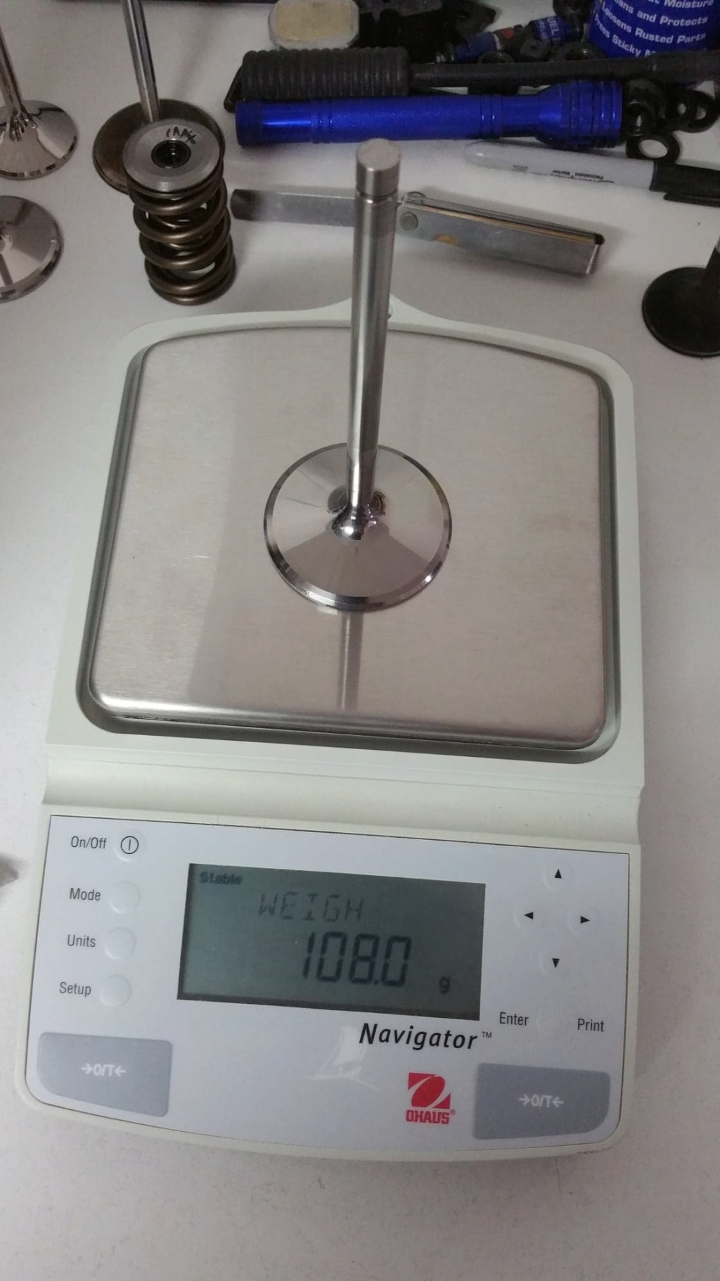

   I weighed a titanium valve that Kaase offers as a upgrade for the SR-71 heads..  was very surprised to find it weighed 111g with a lash cap and 108g without that's a big reduction!
So not to question your findings but could you verify again that 178g for the steel intake valve you listed is correct?...if that is the case it's a great upgrade.. I have never personally seen that much weight reduction when going to Titanium.

Charlie is correct on the weight...
