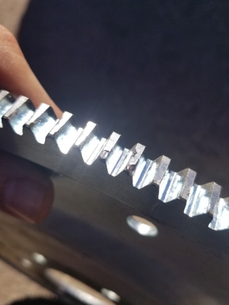

I have a 164 teeth PWR flexplate and a powermaster ultra torque and already changed the starter pinion 4 times in two days.
It seems that the pinion is too far from the center of the flexplate but, in this type of starters how can you bring closer the pinion to the flexplate?
When the motor was bought we didnt have this problem, but since we changed the flexplate the problems began.
The engine is a 559 bbf 800hp 14.6:1

Post  frankcons87 February 13th 2019, 12:48 pm
Lem Evans wrote:Like Randy said.....flex plate starter uses a 10 tooth drive. You have the wrong part.
Must be 10 or at least 10 teeth? I saw a different powermaster with 11 and the visteon (like Randy said) with 12.
I`m using the powermaster ultra torque(part# 9405) and it comes with 9 teeth.
The distance between the pinion and the center of the flexplate is ok?
Here are photos of two different pinions and the flexplate, only used three times each pinion.

I'm using this same starter with 9 teeth and it works great. I use JW flexplate and JW bellhousing.
When I was having problems it was because I wasn't using a midplate with the starter locating ring hole.

Post  procharger 528 February 13th 2019, 5:49 pm
i have had the same problem in the past i welded up the bottom hole moved the starter motor over to it meshed right and re-drilled the hole...never missed a beat since...

Seems to me you have a problem with the flexplate and I would buy a different brand. Is the brand you bought a PRW not PWR like in the first post? It seems to me that elongating holes is about as back asswards fix as you can get when the holes are not the problem, especially if it worked fine before changing the flexplate.
