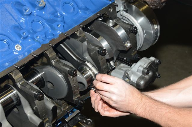

I am not sure I would trust 50 year old hardware for main cap bolts - thats just me.
Kaase's 521 dyno mule short block uses studs on the 2 bolt mains.
That has survived many, many tests. Good luck with your build. Should be a fun ride for sure!

Compared to real world abuse, engine dynamometers are eeeeasy on engines. Cool
And if we look to real world use-and-abuse high performance examples, 98% of the OEM 2-bolt blocks in high horsepower applications that I have seen which had their main webbing ripped out of them had aftermarket high tensile strength main fasteners installed. The same is true with the 4-bolted 2-bolt blocks. Frankly I would rather have those higher-than-normal stresses absorbed by the OEM bolts of steel rather than forcibly imposed upon the block webbing consisting of cast iron. Stronger fasteners belong in stronger blocks.
Generally there is nothing wrong with the fifty year old main bolts--that too has been proven over and over in the high horsepower 2-bolt blocks. But if it makes you feel better then just buy some brand new Grade 8 cap screws and use them instead of the old ones.
