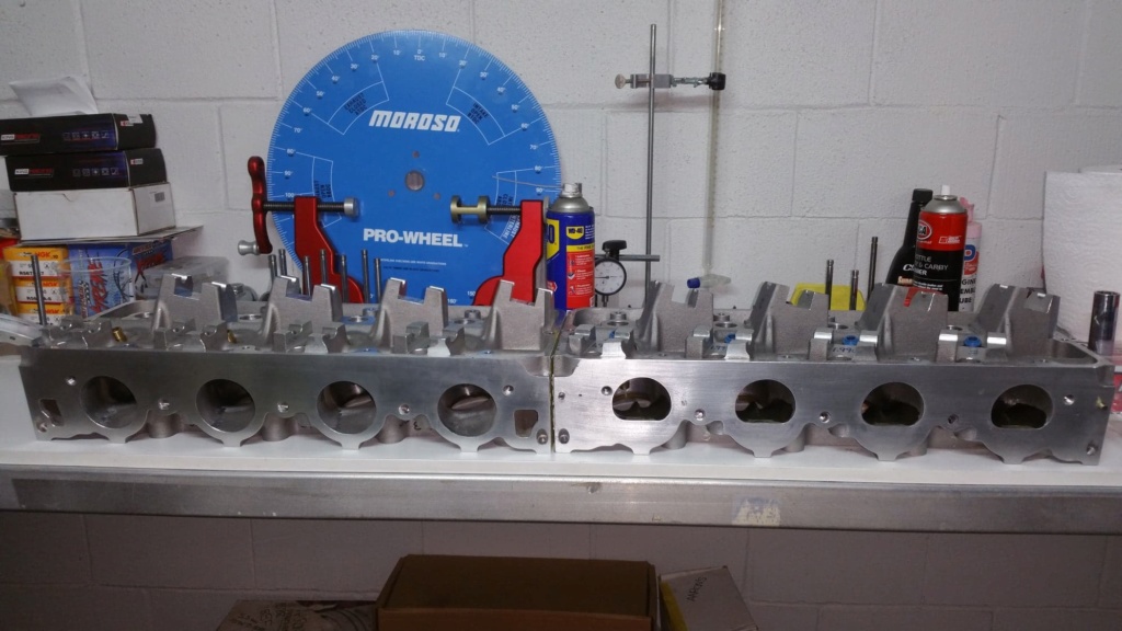

there is an old post on here that showed a flow chart of 523 on intake.it was kaase heads,but had a high port intake mod,that raised the port opening a bunch.wayne gapp use to do that on the original ford heads,using a aluminum block in the bottom of the port with epoxy to seal it. the a441 heads have a raised port as well,about as high as it can go.
,just below valve cover rail.i would think you would need the c and c  a441 heads to make 1200 plus.or you could use the sr71 headsas kaase posted here a while back.

hbstang wrote:there is an old post on here that showed a flow chart of 523 on intake.it was kaase heads,but had a high port intake mod,that raised the port opening a bunch.wayne gapp use to do that on the original ford heads,using a aluminum block in the bottom of the port with epoxy to seal it. the a441 heads have a raised port as well,about as high as it can go.
Years ago, when I was strolling through Ford Power Parts in Norwalk, Calif. on Carmanita Ave.(remember that place? Very Happy ) there was a set of Boss heads that were radically modified. The top of the intake ports were raised so much, they were actually protruding up into the valve cover area. Extra aluminum had been welded and built up , then the ports were opened up way up into the raised area. The valve covers were modified and 'notched' to go over this area. I could not understand at that time why somebody would butcher up a set of heads like that, and it kinda upset me! LOL.
Now I know why it was done!
