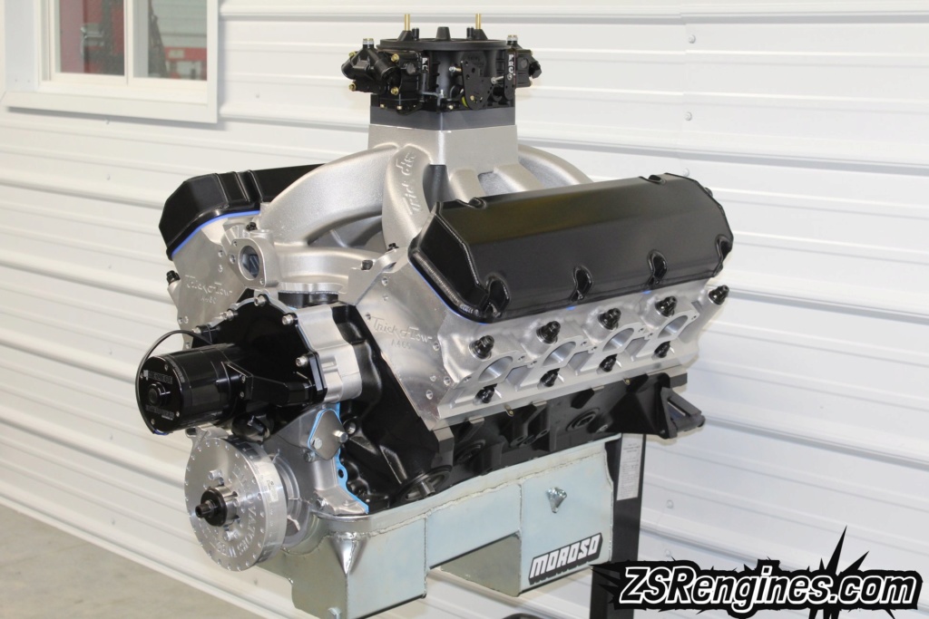

The engine build for my truck is nearing completion. This is my first Big Block after years of nitrous windsor stuff. ZSR Engines has done a great job on this and has made the transition really nice. Going to try and make some good power NA on pump gas. Anyone care to take a shot out what it will make at the flywheel? Should be going to the dyno in the next few weeks.
598 (4.600 bore x 4.500 stroke, 6.7 rod)
11:1 compression (will be ran on 93 pump gas)
Heads are Trickflow 360cc A460 heads (OTB ports, different springs)
Intake is an OTB Trickflow R
Cam is a solid roller (.770 lift)
Carb is a 1050 4500 from PRC.
Will be turned 6500-6700.

Good looking build , detailed cam specs ? carb seems on the smallish side

Carb was sized for it being a little more friendly cruising. Steve at PRC thought a 2 circuit "1050" would support the engine and have great response.

900 hp is only 1.5/ci It should do that and run in the 10s with ease. Zach knows his stuff

He has been awesome to deal with. I took a few liberties in requesting steel rockers, bushing style lifters, and I requested that the cam be kept pretty tame just to play it on the safe side. Goal is to drive roughly 4,000 miles a year including the events and not need much maintenance. Set it on a 2 season freshening is what I am hoping. Truck should weigh in at roughly 4100 lbs.

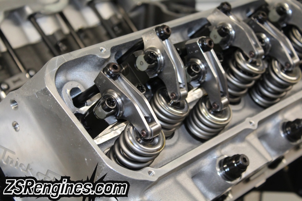

You going to run the triple springs on the street?

Zach set the heads up, and I believe he went with a double spring. If he set them up with triples then my intention is to try them, but I believe they are set up as doubles.

foxbody82 wrote:Zach set the heads up, and I believe he went with a double spring. If he set them up with triples then my intention is to try them, but I believe they are set up as doubles.
I see. You said heads were OTB. OTB is triple.

My apologies Lem, I meant the ports were untouched. Trans is TH400. Aluminum drum, 36 element promod sprag, all trick pieces minus aftermarket case. Wayne what vehicle was that motor in? Care to share more details on the whole combo?

Trying to get up to date here ... when did they stop using the blue stripe NEXTEC springs...?

Triples are on the 360 cnc. . PAC1224 on the 340cc units for several years.

After checking in, these have been changed to a double spring set up. Pac 1300 Series.

Post  foxbody82 November 22nd 2019, 11:16 pm
925 @ 66-6700 Peak HP
803 @ 5700 Peak TQ
