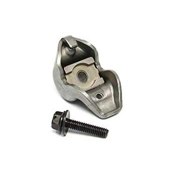

Post  Paul Kane September 3rd 2019, 3:13 pm
At 350-lbs open the factory 5/16-18 bolt should be fine; Randy was going big with his higher open pressure setup.
I've done countless D3VE headed builds using OEM valve train at 0.560" lift, 325 open, 5000 rpm sustained, with zero problems. Use hardened pushrods.
Also, be sure to use the version OEM stamped steel rocker arms that are flat across the top, not the version that is notched with a"V" at the top.
USE THIS:
Pedestal mount rocker D3vepe11
NOT THIS:
Pedestal mount rocker D3vepe10
_______________________________________
P.S.: I know someone who has used OEM stamped steel pedestal rockers to 0.610" valve lift. I do not recommend this for the masses, and be sure to check rocker slot-to- pedestal stand clearance at both fully open and fully closed.
