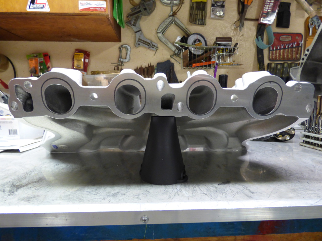

Hwyhogg, I bought this system for my 521 BBF. I am running the D0OE-R iron heads. I read other post on another forum, but they were for the Edelbrock Torker II, same basic intake. They opened up the intake ports. I did the same, using Fel-Pro 1231S-3 intake gaskets. I removed all the injectors, rail and throttle body for grinding reasons. I didn't have any issues with thin runners, altering the injector openings or anything else. I may not have matched the ports perfectly, but they are very close. As far as the injectors go. I called Edelbrock tech people. We talked about cubic inch, my use of the engine and cam. They said the injectors that came in in the Pro Flow 4 were the ones I need. He said, unless I'm over 600 HP, I will not have issues. I'm not sure what the injector number is, but I can look. My engine/car is not running at this moment, so I can't say how the Edelbrock system will function. I'm hoping for good results. One small issue with this system is the height of the distributor. I assembled the engine, with the distributor and ram air cleaner. I own a 1971 Mercury Cyclone Spoiler. The top of the distributor is about 1.75" too tall, and too large of a diameter, five inches. I will have have to raise my ram air cleaner base at least 1.75", if I plan to install it on the car. Edelbrock does not recommend carb spacers, at least for street usage, according to their tech. It would be better to use a spaced between the throttle body and air cleaner base. I can also, cut and modify the air cleaner base to clear at the distributor cap, maybe both that and the spacer. I need to measure for hood to ram air clearance, hoping it will be OK. Good luck!    Edelbrock pro flo 4 P1040712

Thanks for the advice, but the cap on the Edelbrock distributor is the short one, I think. I spaced the air cleaner 1.25" above the throttle body and it should have enough clearance for the stock ram air cleaner base, and still fit under the hood. The Edelbrock intake is not as tall as the stock iron CJ intake, plus the throttle body is not as tall as a Holley 4V carb. Edelbrock pro flo 4 P1040912
