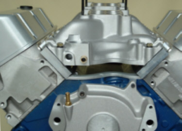

The CJ manifold is narrower as Randy has mentioned. The adapters Price Motorsports makes is to put a cj manifold on a A460 head not the other way around.
http://www.pricemotorsport.com/html/body_ap-11__intake_adapter_kit.html
TFS tunnel ram intake Price_10
