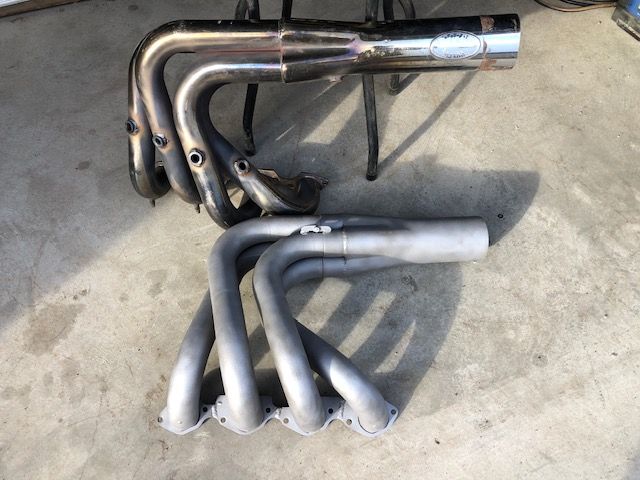

Thoughts
Dyno tested with Hooker 2.25" x 28" L  with 17" x 4" collector.
I pulled an old set of Hooker headers out of the shed:  2.25" x 26" L x 12" x 4" collector.
What do you think the short header would do on the dyno compared to the set already tested ? :
Quick and Dirty Rebuild of  the 565   -  Thanks Lem  - Page 2 IMG_3976
Give them a shot when we go back, or just leave them at home ?

Post  68galaxie April 22nd 2021, 12:39 pm
A header change is a quick change. I would certainly do a comparison.
Cheers
68galaxie

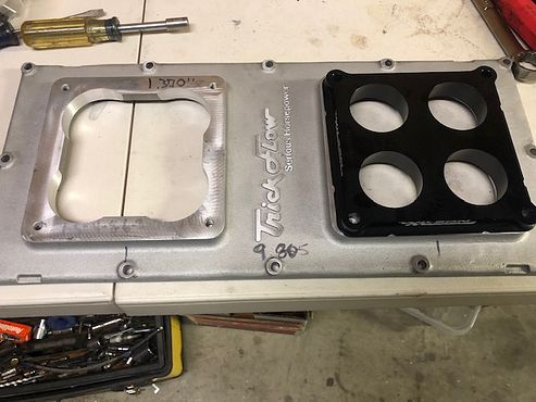

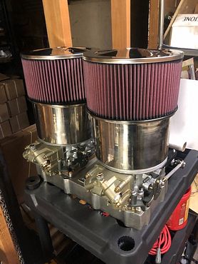

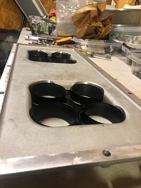

A few new parts:
Quick and Dirty Rebuild of  the 565   -  Thanks Lem  - Page 2 IMG_4135
Quick and Dirty Rebuild of  the 565   -  Thanks Lem  - Page 2 Shear_Plate_1
Quick and Dirty Rebuild of  the 565   -  Thanks Lem  - Page 2 Shear_Plate_bottom_1
Quick and Dirty Rebuild of  the 565   -  Thanks Lem  - Page 2 K&N_Stacks

G-Code wrote:Thoughts
I doubt you’ll see any difference
