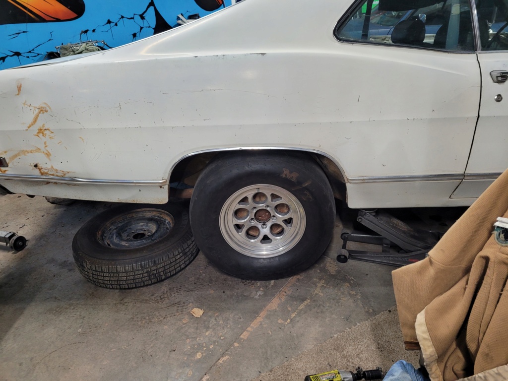

This sucker makes a 28/10.5 look small. Sure wish it was a 4.5 on 5 bolt pattern like everything else we have!
Edit: they might actually be 5 on 4.5. All the rotors and drums on Rockauto show 4.5. If that is correct, that is good news!
Edit 2: They are 4.5 on 5! Whoo hoo!
