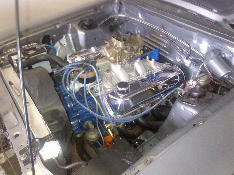

I don't have the A Heads, just Eddy's but I am running 1.5" K Member spacers and it gets you a lot more room around the master cylinder. It really levels out the engine in the car also.
![what the... Img-2014](https://i.servimg.com/u/f97/19/33/99/96/img-2014.jpg)
Your deal looks a bunch taller than mine, just a thought!!
