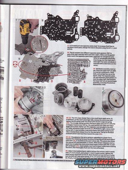

The only thing I read that didn't sound correct was their servo spring .In the article it states their servo spring helps the servo APPLY harder .Doesn't the servo spring help the band come off the drum quicker ?Good to hear about that superior servo as well .Even with the nice article in hot rod I would still prefer the trans go 67-1 2 .Greg I should be online by now if you cant get the mag in Australia .Doug

I could be wrong, but believe they use a slightly softer spring to give a "harder" apply, Frank advised me to re-use my original "P" servo spring since it had a higher spring rate and was more robust in design than the spring that came with the Superior servo. Never tested the Superior spring sent but the "P" spring/Superior servo combination work great together.

The sonnax kit has the two light springs . I don't usually use them . I did post the spring rates on here some time ago..
I've only ever used the heavier of the sonnax springs as a trial in a trans i built( it originally had an even lighter spring) I had hoped to see what it was like but unfortunately not sure if the guy ever got the car going yet

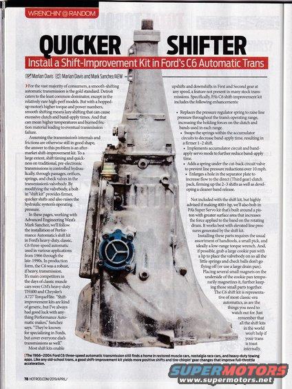

I was able to finally scan the Hot Rod magazine article and get the pages to scan correctly. It seems I do a better job of smacking my fingers on my left hand with a hammer than figure out computer tasks. Hope this helps(somewhat).
https://www.supermotors.net/getfile/1145920/original/img_20190223_0001.jpg

Hey Thanks heaps for sending through.. Seems they have covered it not too badly
