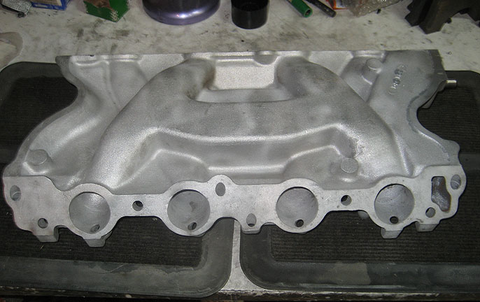

The 460FI heads are easy to apply common sense porting, and offer great improvements with little effort. The E7TE heads require only a little bit more work than the F3TEs since you typically must install the bigger intake valve.
For a 460FI upgraded with flat tops, installed into an F-250, and which will use a smallish "low to mid range cam," the 2.08" intake valve might be just fine, or perhaps a 2.11". An intake valve bigger than that might be better suited for a stroker engine used in a similar application.

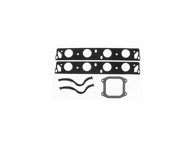

The factory 460FI aluminum intake benefits greatly from porting (enlarging) the runner exits at the cylinder head mating flange; the rest of the runner and plenum volume are good as cast for what you are targeting.
Lastly, I suggest you use the Victor Reinz intake gaskets for port matching these two components to one another, not the Felpro.  The Victor Reinz is a great template for a truly round intake runner:
FELPRO:
Valve size for E7TE heads Felpro10
VICTOR REINZ:
Valve size for E7TE heads Vr460f10
