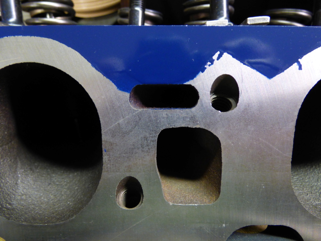

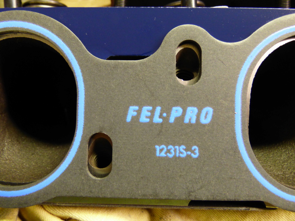

I'm rebuilding my 71, 429 CJ engine. I have worked on many small block Fords and 351C, but I'm a bit new to the 429 CJ engine. The heads have me puzzled. I sent them out for valve work and machining. The heads look great! I installed them on the block and when I was checking the fit of the intake gaskets, Fel-Pro 1231S-3 intake gasket set, I noticed a small opening, just above the exhaust crossover port, in the center of each head. The intake gasket doesn't cover this opening. What is this? I can't find anything about this in my engine manuals. I'm installing a new Edelbrock Pro Flo intake and it doesn't cover this either and neither did the stock CJ intake. A Facebook group, BBF, says this is a barrier between the exhaust port and oil side of the head, so the engine oil doesn't burn inside the valve cover area. Is that a fact, or is this for something else? Thanks.

Exactly what it is ... It is merely an air barrier so the exhaust crossover does not transfer as much heat to the oil directly above it under the valve cover.
That gasket is actually higher in that place than an O.E.M. gasket; covering part of that void.

Thanks for the reply. I was told this on a Facebook group, but they weren't sure either. It does make sense. Do you think I should trim the intake gaskets, so the port will be fully open? Trimming won't interfere with the intake. I may as well. Thanks again! Richrmcomprandy wrote:Exactly what it is ... It is merely an air barrier so the exhaust crossover does not transfer as much heat to the oil directly above it under the valve cover.
