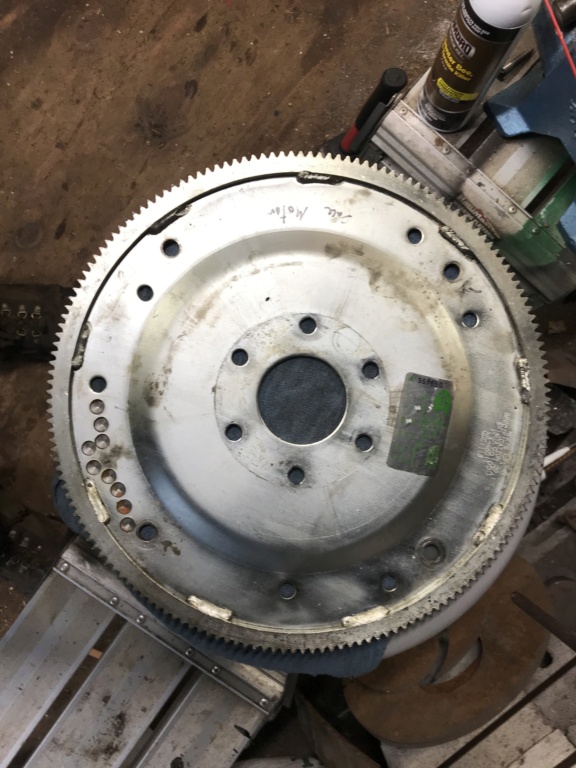

I've got a 545 stroker that I assembled for my mustang about 8 years ago. From the beginning it has been bolted to a c-6. I've put it in my bronco and am not happy with the auto in this application. I'm going to swap in a NP-435 and have the swap kit from L&L. My question is about the balance of the motor. The flexplate was drilled in nine places, close together, not all the way through. The motor is internally balanced. I don't want to pull it apart to check the balance, the machinist that did the work has retired. Is there a way to check if the flexplate was drilled just to balance the flexplate and not to balance the motor? I was thinking that maybe the flexplate wasn't zero balanced when new and he corrected it first, verses taking some weight out of the flexplate to balance the motor. Thanks.
I'll see if I can get a picture of it here.

Mustang-junky wrote:I've got a 545 stroker that I assembled for my mustang about 8 years ago.  From the beginning it has been bolted to a c-6.  I've put it in my bronco and am not happy with the auto in this application.  I'm going to swap in a NP-435 and have the swap kit from L&L.   My question is about the balance of the motor.  The flexplate was drilled in nine places, close together, not all the way through.  The motor is internally balanced.  I don't want to pull it apart to check the balance, the machinist that did the work has retired.   Is there a way to check if the flexplate was drilled just to balance the flexplate and not to balance the motor?  I was thinking that maybe the flexplate wasn't zero balanced when new and he corrected it first, verses taking some weight out of the flexplate to balance the motor.  Thanks.
Jess
Engine balance question Img_3210

The balance shop can match a flywheel to the flexplate , just take them both.

And never use that balance guy again.
