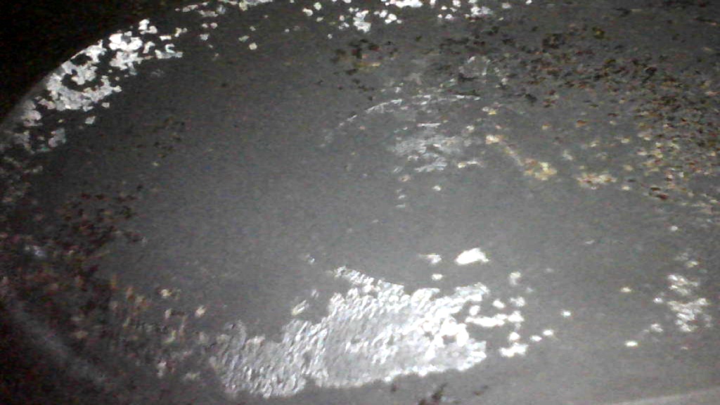

What a day. Looking for advice and what direction to go. I just installed a Holley Sniper a few months ago. I have put maybe 100 miles on it tops since I installed it. Last week while adjusting the iac it went extremely rich and and spewed black exhaust before quitting. I know what caused that and have fixed that problem. So today I figure I check my plugs and do a little tunning. The plugs did not look too bad, so I decided to use my endoscope and check out a couple of the cylinders just to see how they looked.
Well, did I get a big surprise! See pics. I know that the last time I checked the pistons when I got my endoscope back in August they were in good shape. Question- is this more a pre-ignition issue or detonation and what recommendations to correct it. The car is to loud to hear any knocking. Also, how would you rate the damage that has been done. Still ok to drive if I get problem fixed? The engine seems to be running fine as is.
Here is the engines current configuration.
460 with d0ve-c heads.
10:1 CR
Howard hydraulic roller cam -dur 282/286, Lift .600/.593,
Dual plane intake with 1/2 spacer
Holley Hyperspark distributor - current timing is 15 idle - 36 cruising - 32 wot. No advance built in at the moment.
AFR 13.5 idle - 14 cruise - 12.5 wot.
Running autolite 45 plugs
Running 93 octane but had to put in about 1/2 of tank of 86 last week.

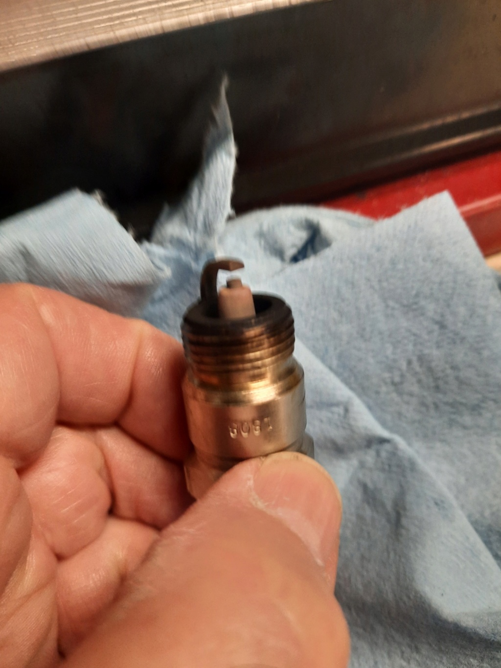

These are the worst two of the bunch. Also two of the plugs. Thanks for any help you can provide.
10:1 CR

What caused the IAC to go wonky (yes that’s a technical term
) Have you ran a compression check? How about a leak down check? What is the plug gap?
The piston top looks weird but the plug looks pretty good.

I had the idle spark on while trying to adjust it. Didn't know that was a no-no (also technical term
) at the time. Turn the screw too far and idle dropped and almost stalled. The afr reacted dumping more fuel in but it was to late and flooded and stalled.
Compression was 210 to 213 last time I ran one about 6 months ago. Never done a leak down. Plugs are gapped at .040. I should also mention I have a MSD6a box and blaster coil.

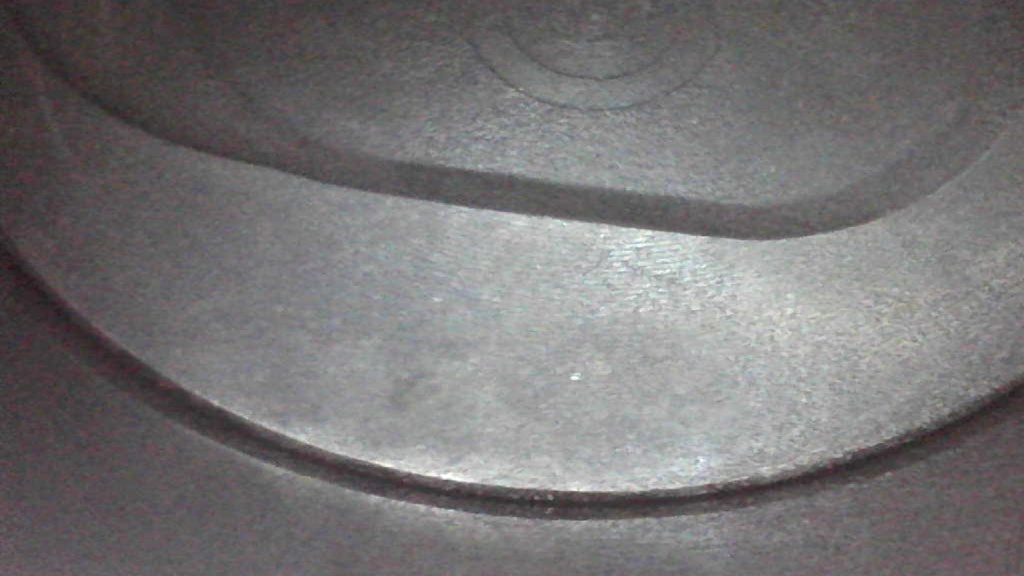

Here is a picture of the worse piston above back in August before the pitting started.

The plugs show a rich mixture where the ceramic has a thick brown glaze. I dont see aluminum flecks on the plugs that indicates detonation. If the piston tops are a rough surface I dont see an issue.

If you look at the top two pictures in the original post the piston tops are pitted where previously they weren't - see picture in previous reply. The cam is what came in the engine when I got the car. Engine was built by a professional shop. The engine has always run great and still does but from what I'm seeing my pistons are taking a hit of some kind.

Are you sure that is pitting or is carbon built up and flacking off. If it ran rich enough to start blowing black smoke it doesn't take long for the carbon to build up. I have had carbon built up before and busted it loose with sprinkling water down the intake while at a high idle

69F100 wrote:Are you sure that is pitting or is carbon built up and flacking off. If it ran rich enough to start blowing black smoke it doesn't take long for the carbon to build up. I have had carbon built up before and busted it loose with sprinkling water down the intake while at a high idle
Wish it was but I don't think so. The pitting in the picture doesn't show as well as the actual video on the phone.

Honestly, I don't think 93 octane is enough, I would add octane booster to every fill up because what it says at the pump, is not always what it really is.
Also, you may want to try a little colder plug.

I have order some colder plugs today. Going with NGK AR6FS. They are one step colder than the Autolite 45's I am using. I thought about the octane booster but I don't think my compression is high enough to warrant it. I might give it a try to see if I notice any difference. I'll try the plugs first and monitor it and then go from there.

I ran a compression test yesterday and all seems fine on that. 10 lbs. max difference between all cylinders. Today I ran a leak down test and no issues found there either, so any damage done so far is minor if you want to call it that. I took the endoscope again and used a 45-degree mirror attachment and was able to get a look at all the valves today. I think I have two separate problems.
Problem 1: The exhaust valve in cylinder 5 also has pitting in the center of it (see picture). This is directly above the pitting in the piston. This now makes me suspect that something got into the cylinder. After thinking about it for a while I remember that when I was replacing the valve cover gaskets that the stud came out of the upper front conner above # 5 intake port. When I screwed it back in it stopped momentarily and then went in and seemed a little deep. I now do believe it punched through the casting and I got a piece of the cast iron in the cylinder. I know that this can happen with the 460 heads. I checked out the cylinder again thoroughly and didn’t see anything laying in it so I think it's been ground up and blown out. So, for now I’m writing that off as the cause of the pitting and will keep an eye on it.
Problem 2: I still think I might have a little pre-ignition / detonation going on based on the looks of some of the other pistons. I think it's more preignition than detonation. I will proceed to try to correct this by going with colder plugs and then adjusting the timing and afr as needed. I have already ordered a set 1x colder plugs but have decided today to step down 2x. I will pick up a set on Monday. Going to go with NGK AP7RF. I’m will then make afr and timing adjustments as needed. I will continue to monitor everything very closely for the next several months to see if there are any changes.
Thanks to everyone for the suggestions and help.

You "may" have had a situation where the 'piece" blew around to other cylinders before it exited. I have seen this before where "innocent" cylinders were damaged by parts from blown up cylinders.

Very good point. Something I didn't think about. I have a dual plane intake so it would have stayed on the left bank. After looking at the pictures again the two that I posted pictures of are numbers 5 and 6 with 5 being the worst and then number 6 coming in second so it makes sense that I might took a hit on a couple of them.

I take the spark plug and put it in the vise, then take my air powered cut off wheel and carefully cut the threaded part off, be careful not to touch the porcelin part, as after you cut off the threaded part at the base of the plug, you can easily see where the coloring on the porcelin is.

Another source for a colder spark plug is an autolite 124 .Which came in big ford trucks (f600-700) with 391 engines .I have used them with great success in high compression Fe engines .That plug should work fine in yours also .Doug

The big problem is that the 124 is a standard tip type plug vs the projection tip on the 45 and is more prone to fouling. I didn't realize at the time that I ordered the NGK's but they are standard tip also. I'm trying to stay with a resistor projection tip so I ended up going with Champions RF9YC.
