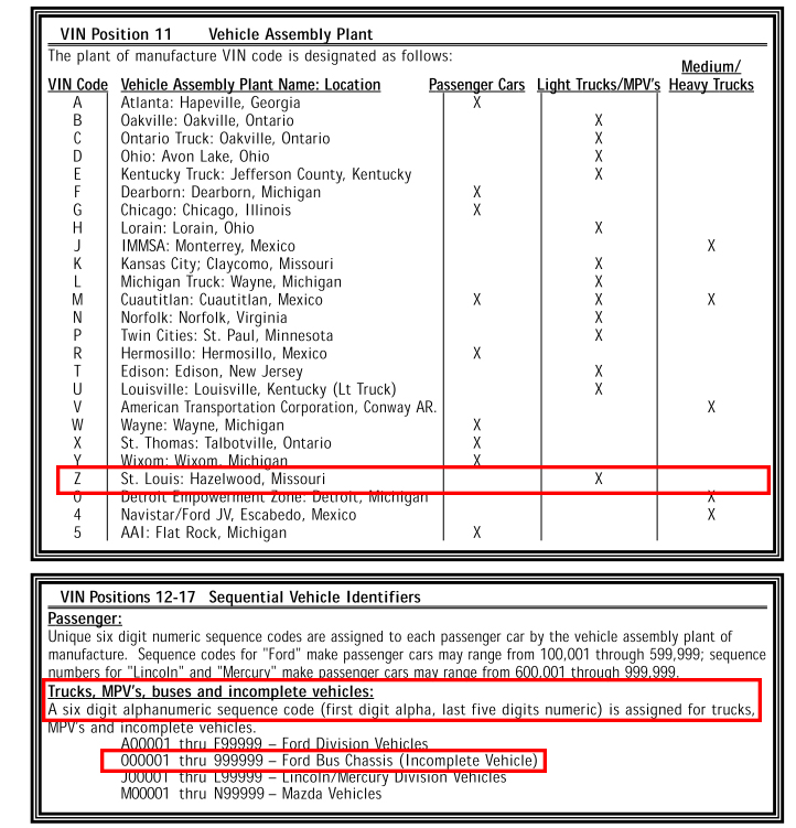

9Z619824 translates
9Z619824 translates 1969 model year Mercury fr St Louis Assembly, which at that time was assembling Mercury Marquis, Mercury Monterey & Mercury Marauder. Pretty sure one couldn't get a CJ anything in any of them. 619824 would match the last 6 digits of complete VIN to the originally installed into car......... provided same VIN had same yr & assembly plant code.
Never have heard of a 429CJ in any 1969 anything. I believe he was trying to figure out the engine and if the air cleaner ever came on a latter year model CJ. Without the driver side air valve, I would agree it did not, or at least it should not have unless the factory screwed up.

Re: 429 4v identification
Wasn't trying to say that it came out of a Tbird just pointing out that it couldn't have been out of a unibody car or Police Interceptor in 69 which eliminates the possibility of it being anything other than a standard 429 or 460. Once that is established I wouldn't really care whether it was out of Ford Merc or Tbird its still a good foundation for a strong street type build for a car or pickup.supervel45 wrote:Does not look like they made any T-Birds in St. Louis.
https://automotivemileposts.com/prod1969tbird.html
