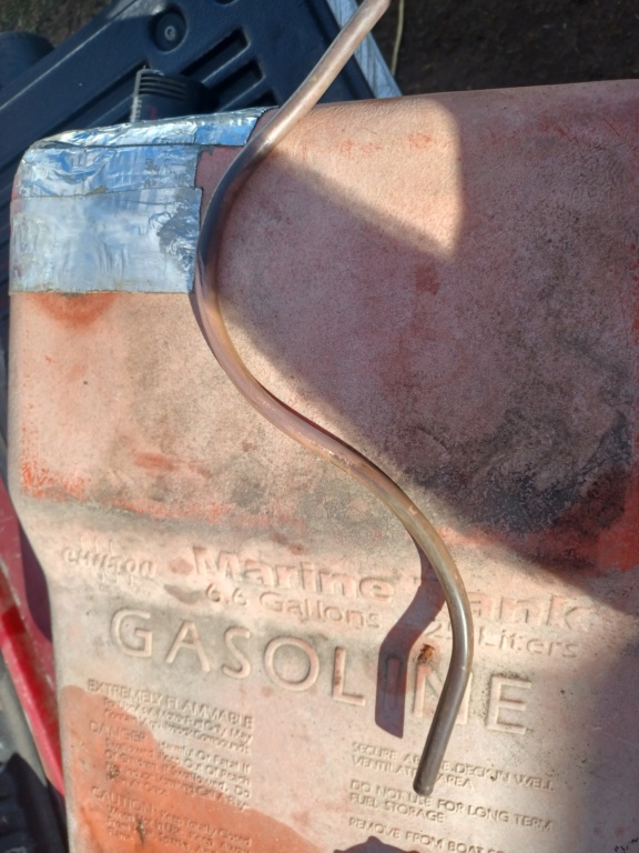

I Played with That Throw Away Marine {Boat} 6.6 Fuel Tank Again Saturday as This "Drunk Whore" is Very Thirsty and Less Then 2 Gallons was Not Getting It.
The First Temporary Fuel Pickup by The Blue Flashlight was a 3/8" Copper Tube Shoved Over The Aluminum Block, With About a 3/16" Hole Right Angle Feed Tube. It was Meant Just to Fire The Engine Off and Get it Running.
^ It Performed That Duty Quite Well Until The Old Carter Electric Fuel Pump Gave Up the Ghost and Locked Up.
A Second Used Throw Away (Was Used as a Diesel Up Pump) Carter Electric Failed to Self Prime so The Kitty Litter Bucket Under the Hood for Now with the 37GPH Test Pump LoL for Now.
Need a Fuel Cell or Convert the OEM Rear Tank to Sump. For The Engine and Street Driving for Any Kind of Range.
Planning a 130 GPH Holley Mechanical Fuel Pump for The Engine.
It Has What Appears To Be a Factory Block-Off Plate Now. These Trucks Came With Two (2) Intank Electric Fuel Pumps and a Holley 4 Barrel 600Cfm VS {4180 Type} Carburetor OEM. Some "May Have also Come with a Mechanical Engine Fuel Pump Plus Electric in Tank Pumps. Not Really Sure What Mother Ford Had all going on in The Mid 1980's { To 1988 } Right Before Truck EFI on the 3/4 Ton and Up Rigs?
^ Already Have One (1) Holley 130 GPH Mechanical Pump, From The 429 as Well as a Diaphram Replacement Kit. Doubt It Needs One Either.
A 140 GPH Electric for The Nitrous on a Seperate Cell For Race Gas. Don't Really Need That for a 150HP Shot Though. Never Have in the Past Anyway.
Here's a Few Pictures of the "Junk" and The Temp. Revamped 3/8" Copper Tubing Pickup and Line.
The Fuel Line Will Be 1/2" Copper Tubing on The Permanent Deal For Both.
Also Have Some Chrome Lakewood's on The Way, Until I Can Make or Locate Something Better in The Traction Department.

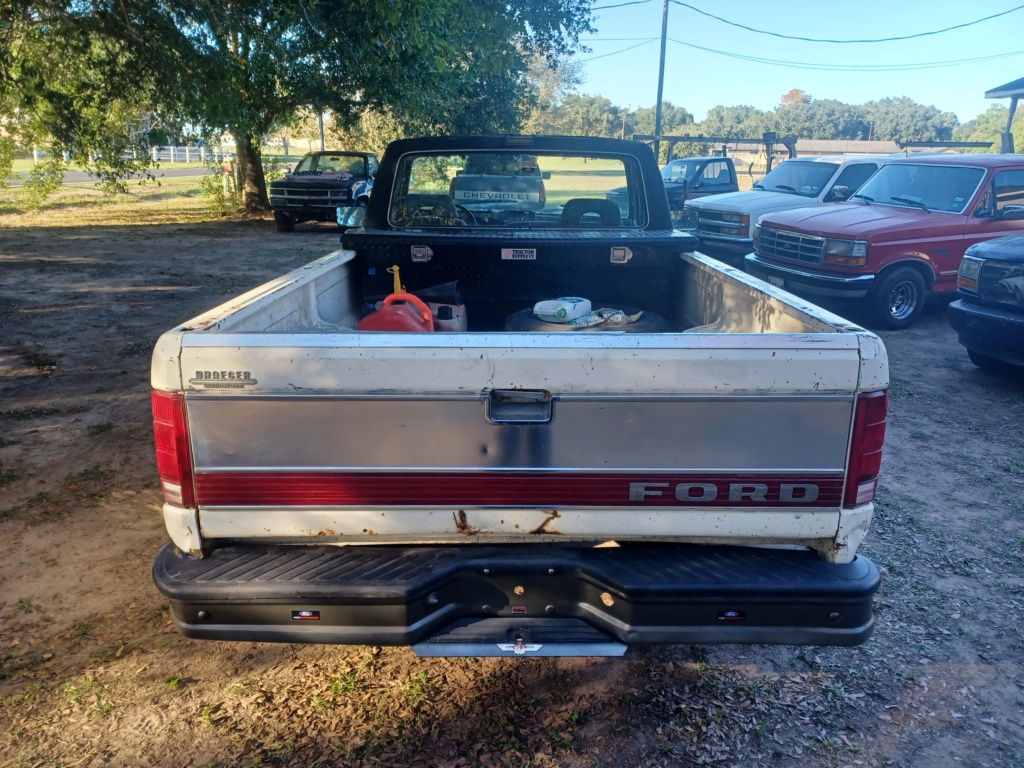

supervel45 wrote:Finally On The Truck. Two Big High Strenght Bolts and One Short Broken Stud for Attachment and Quick rRemovell if Weight Savings is Desired.![]()
I Think It Looked Better Without The Bumper Because It Showed Off The Snazy Differential but, It is Nice To Have Some Rear End Protection on These Old Trucks as Tailgates, Tailgate Aluminum Trim Pieces, and Beds are Getting Harder to Come By and More EXPENSIVE...![]()
I Did Go Ahead and Two Tone The Bumper.
I Added Dupli-Color "Cast Coat Iron" Engine Enamal.
I Located A Few Three (3) Nice Stickers One of Which or Maybe Two (2) are Pretty Vintage. I.E. The Holman and Moody and The Holley Re-Pro Float Bowl Decal.
The Weather is Clearing/Warming Up and That's Very Nice.
Hopefully I will get my Help over Soon and get the New/Old 2,800 Torque Convertor put in before or during the Weekend.
Then It's off to Traction Bars and The Fuel System, When the Fund's Catch back Up.
For You Guys Around the H-Town Area I may be getting My Joy Juice Deal Back Up and Pumping/Freezing Again, Hopefully.
On The Bumper Pictures To See The Two (2) Colors, As They are So Close, You Almost Have To See It In Person To See The Difference. They Are There Though.

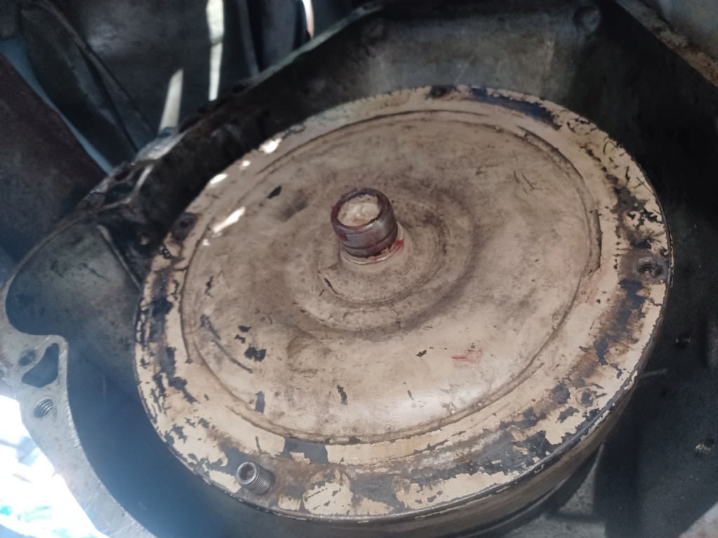

The Convertor is a Robert Brittains, of Brittians Parts Service in H-Town {Berry Rd.}. I have Had it about 3 Decades and Put Countless Bottle's of Nitrous To It, in a 5k Pound 429 Truck. No Problems Yet.![]()
The Convertor is a 12" with Brazed Fins. It Stalled at 2,800 Behind the Low Compression Mild 429 with 3.5 Gears.

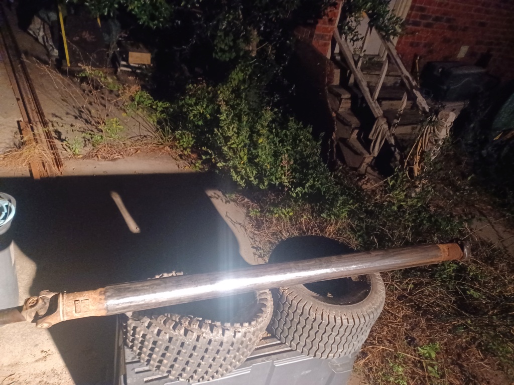

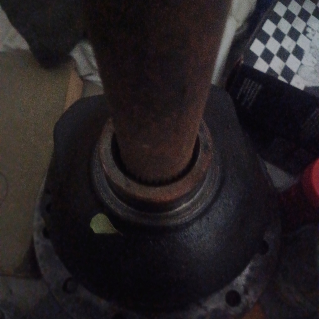

Part II: The 2,800 Stall is in. Well The Transmision and Torque Convertor are Bolted Up Anyway. What a Pain in the Ass.
Cleaning and Painting Drive Shaft, Crossmember, Bolts and other Parts Now to Complete the Job.
Another 4 Hour Deal Turning into a 3-4 day Project, as Always.
Upside is Taking Your Time Usually Equals a Nicer Finished Product, hopefully.

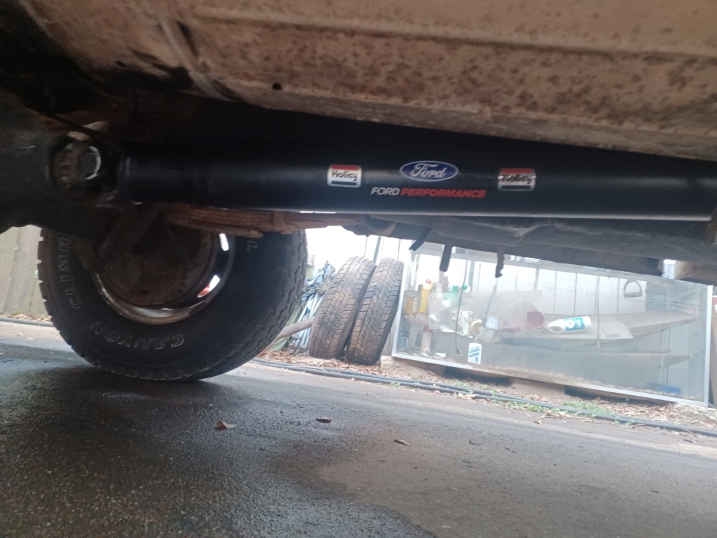

I am Going To Burn These Stickers on The Driveshaft for Starters, Because I Have Them, Plus Dual Quads Need Dual Holley Stickers After All.

Christine's Nightmare 2,800 Stall Completed
Seems Like Somewhat of an Improvement. Nothing Major but, Every Little Bit Helps.
The Differential, Intake/Carburetors/AirCleaner and Driveshaft are about the Best Looking Parts of The Truck, in my Opinion. That's Fine By Me.
Did Not Want The Bling on This One for Reasons

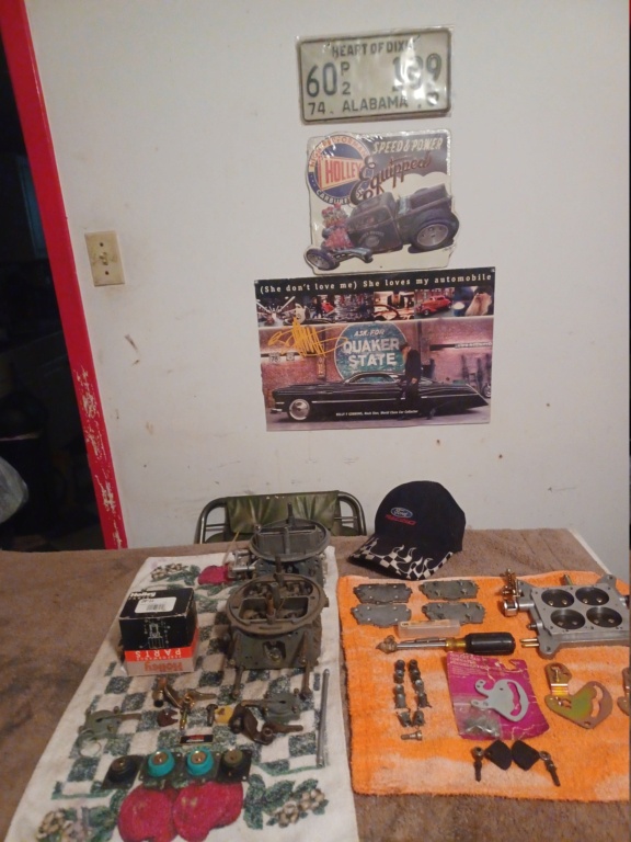

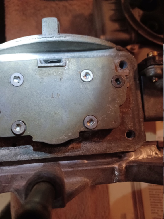

supervel45 wrote:The Cheap Easy Way.
Start with This Kit.
https://www.ebay.com/itm/253019123208?hash=item3ae91d6e08:g:Lu0AAOSwOFddQPZr&amdata=enc%3AAQAIAAABIK4OY49mG4jznOqXsdF%2B41S7q34rQ1PRWNbWg%2BQssNsc4mGck3cgvZ149jjzSDJDl%2FkeUL8%2Fhoy5Qq8omiYyhoFepReOcVWYE%2Fea3bQoK%2FfbOVqDRe58Q9RAZBcN8TtBmwK16tiHMcuiMSJnHBi4a%2B0VGmyCEU8aCH%2FpOHCVDvvXIskkJjDEwVATEwRpilRHRTZ7ktWpLsfvCZnUmHDJTZqMMoU0nnEFrEVj3YEgqf%2FZjWeR47VfmR0S%2BE6kyk9YvWaO9eRdh63XaiLu2YUesNtsMzxKKe8kzEiRsv6DCeOGoyCFdgdO0YLAdOYvDwnW3cOhvzZJ5nL%2FM0BKo6I1uDNpwjkkAXCLbXUzdh7lCms82nP2Y0Dj3EnO%2BLO5Op8otA%3D%3D%7Ctkp%3ABk9SR5Tc6NXsYg
Go to the Local Hardware Store and Buy a 2 to 3 Buck 1/4" Collar with an Allen Head Set Screw.
Move the Front Carburetor Linkage Connection to the Lower Hole and Loose the Aluminum Spacer that Usually goes in the Large Top Hole. You can Shim the Slack with washers if you Like.
Put 1/4 Collar in Front of Linkage Attachment Arm the Distance you would Like before it will Open the Throttle on the Secondary Front Carburetor. Lock the Set Screw.
Check Operation and for Binding. Done.![]()
V Note on the First Picture Below, The Linkage Arm is Still in The Upper Hole with The Collar Set For Progressive. You Will NOT GET Full Throttle on the Secondary Carburetor because of The Geometory.
You Can Slide the Collar All the way Back to the Linkage Arm Though, and Not Use The Set Screw That Goes in it, {Linkage Arm} That Comes in The Kit.The Catch With it is if Someting Binds the Carburetor, the Return Spring will NOT Pull it Closed, Just Like When it is Setup For Progressive.
For The Price of These Kits, I Believe it is the Most Bang for the Buck Out There.
I Have Used The Edelbrock Kit on my Last Dual Quad Setup. It was Nice Also but, The Price Back Then was 27 or so Bucks. They are Much Higher Now I Believe and Don't Do Anything More than This Kit does that I can See.
Going to Turn the Wick up a Tad.
A Little More Cfm on The Secondary Carburetor With a Lighter Vacuum Pod Spring (Silver) and a Quick Change Spring Top.
With The Black Vacuum Pod Springs I Have Now, I Would Doubt They are Opening to 800Cfm Combined?
I Have Not Done The Paper Clip on The Pod Rod Trick, I Will Though in Due Time.
I Have Another Quick Change on My 780VS 3310-1 4150 Also. Not Going to Rob Peter to Pay Paul as I Have had the 780VS Since the 80's.
I will Pick Up a New or Used One on Fleebay (Only Need a Top) for The Primary Carburetor.
Since These Have The Boss's for The Vacuum Balance Tubes, I Will Go Ahead and Plum Them Also.
^ I Doubt They Do Much But, They Sure Look Cool, Like The FE 427 2x4 Deal.
Yes I Know About The QFT Adjustable Pod, Both the Top Only Cheapie and The Fancy Anodized Red Aluminum one, (Had one of the fancy ones new in the package and sold it off) I am going Old School on This Truck to See What I can Get with Mostly Vintage Parts on a Budget Build.
If You See This Stuck On It With a Mechanical Tachometer and Run With a MSD-6AL Box, You will Know I Have Gone Native

And A Few Pictures of The List #7128's.
For Reference of The Venturi Size I Threw in a 3310 780Cfm Main Body and a Complete Holley List #4455-S 855VS From 1968 That was Sold by Holley.
I Believe They (4455-S's) Were Intended For Dual Quad Cross Rams as Well as I Guess, In Line Tunnel Rams and Dual Quads.
Oh and PS: Christine Just Picked Up a Cylinder and A Half In Part Due To Some of my BaFoonery and Part to Having Other Complications with Unforseen Problems Lining Everything Out From Scratch.
I'll Just Say She is an Extremely Happy Camper with The Extra HP That was Dangling Off One of The Spark Thingies and Changing a Wet One.
"It/Shit Happen's"
PS 2: Since I Have So Much So Called Holley "Junk" I will Likely Build Out The 750 Center Squiters (Have Two{2} Main Bodies Just Sitting Around) and The 780-800VS's and See What Gives Between Them for Comparision.

This Holley List #7128 Came With A #47 Thick (Old Style) Metering Plate.
As You Can See in The Holley Chart it is a .031" IFR and an .089" Main (Jet) Feed Hole, Which Equates to a 78 Jet Size.
The 3310-2 and Up Come With a #21 Metering Plate. They Have a .040" IFR and a .081" Main Jet Feed Hole Which Equals a 74 Jet Size.
Not a Big Problem if Building Dual Carburetors.

A Short Tailshaft C6 With a Custom Geared Transfer Case.
One That Would Knock The 3.54 Gear Down to 4.10 or 4.56 in Low.
Shorten The Driveshaft if Needed and Install The Floor Shifter.
I Will Have to Check Into What's Out There in That Department Nowadays. 4x4 Friends That are Builders/Fabbers are Good to Have for Such Projects.

Christine's Nightmare Holley 4223 *50 Center Squirters Inline Converted to 6160 Sidehung Bowls.and Metering Plates
I am Going to Convert These Two(2) 4223's for Inline Use on The 472PI and Whatever Cid The D9 Comes Out As.
The Engine in Her Now, Can Give Them a Go For Kicks.
The D9( will Likely be Built with The CompCams SFT 294B8 I Have or Maybe a Used Solid Roller Cam. Or a Bigger SFT? It will Likely be 11.5 All The Way to 14/1 Compression Depending on What Parts/Heads I Come Up With and How Crazy I Go Decking and Milling The Heads and Block?
It Will be a Flat Top Pistoned Engine Either Way.
^Might Get Low Tension Thin Rings and It Might Not. Likely Not Though
As You Can See From The Pictures or at Least One of Them, One(1) 4223 has 5271 Primary and 4519 Secondary Metering Blocks.
^ It's The One With The Custom 4294V Bowls I Had Lazer Etched. By Having The Holley List #3310 780Cfm Metering Blocks, Which are Fine By The Way For an 850, Is Why I Scored it So Cheap on FleeBay.
It's Brother Has The Correct Metering Blocks Though.
The Metering Plate Can Come Off, and The Original Block Right Back On. No Problem There, and The Tapped Metering Plate Screws will Never Likely be Noticed, Except for The Most Astute Old Old Builders Who May Have Had One Back in The Day, Way Back.

Christine's Nightmare 4 Link Dana 60 Spool 32X14 Slicks 4.10's Ect. Or Other
I am Surprized How Light a Dana 60 4-Link Back Half Is.
The 70 Ring Gear was 10 Lbs and The Detroit Locker as Well as The Open OEM Carrier was About 35 Lbs..
A D60 With a Spool or Light Weight Spool Will Be Much Less!
I Am Also Surprized How InExpensive Used D60 Parts Gears and Spools are on FleeBay Going By Current Listings and Completed Listings!
The Differential Housing Was Empty, Except For The Axles (Strange) When I Un-Loaded It Off The Truck By-MySelf.
^ And NO, I Did Not Tie a Chain To Something and Drive Off and Let It Drop.
As A Matter of Fact When I Was Lowering It Down, I Did Not Drop It at All, By Angling It Off and Sliding It Over The Edge of The Tailgate.
