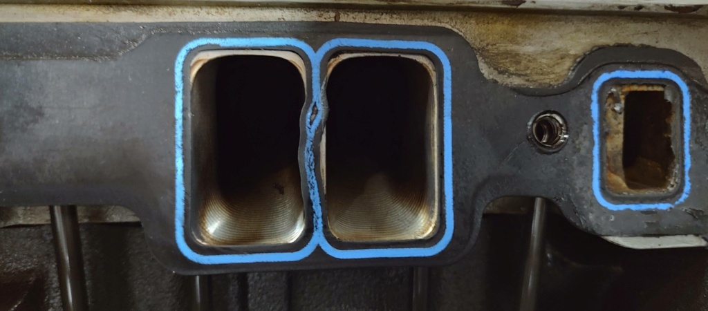

The FelPro site gives some info on with and without steel core. Without is designed for racey applications where the intake will be pulled regularly for service and they're easier to trim without the steel core to match ported/aftermarket heads/intake. The steel core are for extended service. I've been down this road. The Ford pic was when I pulled the intake on the 460 that came in my Fairlane and the Chev is after a few thousand miles in my other car (a couple other ports were worse). I checked all surfaces for straight/angle and both were perfect. I now run steel core only. Sorry about the Chev pic. Educational purposes only.

the tree man wrote:The FelPro site gives some info on with and without steel core. Without is designed for racey applications where the intake will be pulled regularly for service and they're easier to trim without the steel core to match ported/aftermarket heads/intake. The steel core are for extended service. I've been down this road. The Ford pic was when I pulled the intake on the 460 that came in my Fairlane and the Chev is after a few thousand miles in my other car (a couple other ports were worse). I checked all surfaces for straight/angle and both were perfect. I now run steel core only. Sorry about the Chev pic. Educational purposes only.
Thanks for the Pictures and Info. Don't sweat the Bowtie, I have no problems with that and Like all the Big American Three.
I've had the Fel Pro's look like that a few times on my 466 With Aluminum CJ heads and switched to Mr.Gasket Ultra Seals IIRC and no more problems!!

I noticed the Felpro intake gaskets looked a little off on my SCJ intake when I pulled my 429 apart. They were still holding but looked similar to the ones in you pictures. I have seen it on the SBC's Also.
