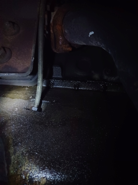

Post  curiousgeorge November 2nd 2023, 7:00 pm
After talking to Paul I think I’m going to tap mine and add a tube and use one of the front sump dipsticks that I have. Dipstick and tube Img_6210
Dipstick and tube Img_6211

Post  supervel45 November 2nd 2023, 10:41 pm
curiousgeorge wrote:After talking to Paul I think I’m going to tap mine and add a tube and use one of the front sump dipsticks that I have. Dipstick and tube Img_6210
You Kinda Lost Me.
Are You Going to Plug the Oil Pan Hole?
Then Use a Timing Cover with the Dipstick through it?
The Reason I ask is because I Have a Threaded Truck Pan and I was Considering Using one of My Timing Chain Front Covers and Dipstick.
If I go that Route I guess I would have to remark the dipstick for proper level though with the Truck Type Pan.
^ Or Maybe Not and it shows the correct level also?

Post  curiousgeorge November 3rd 2023, 7:17 am
No I was going to tap the pan and use some adapters then get the tube the correct length to use the dipstick I have.
