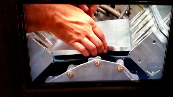

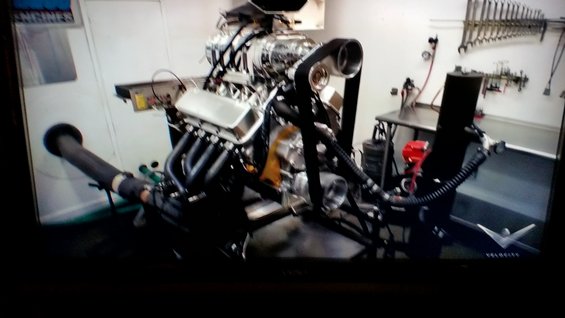

Post  Doug Rahn August 11th 2018, 11:15 am
Lem Evans wrote:Raised intake ports. Requires china wall spacers like the 7721 edelbrock sbf head.
Good eye Lem. They dropped in a lifter valley plate then the manifold. They said it made 1027hp @6700 and 903tq @ 4600 with the TBS 871 blower on pump gas. He also said it had longer valves with a diameter of 2.375 In. and 1.76 Ex.

Jon Kaase SR71 Cylinder Heads Empty Re: Jon Kaase SR71 Cylinder Heads
Post  Lem Evans August 11th 2018, 11:53 am
Post  Doug Rahn August 11th 2018, 11:58 am
Suspect LOL, I should have guessed you would be in the know.
