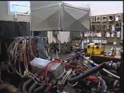

Parts used in the build:
Ford SVO A460 Block
Scat Billet Crankshaft 4.5 Stroke
Scat H Beam Rods
JE Forged Pistons 4.6 Bore-14:1 Compression
Trick Flow A460 Heads / 2.35 Intake/ 1.90 Exh (ported by Charlie Evans)
Jomar Stud Girdles
Trick Flow A460 Tunnel Ram Manifold (port match by Charlie Evans)
Quick Fuel Carburetors (2) 1050 cfm
Cam Motion Solid Roller Cam (Lift.813/.779-Duration 287/301 - CL 114)
Crower Hippo Solid Roller Lifters
Crane Gold Race Rockers 1.73
MSD Billet Distributor
MSD Crank Trigger
Meziere Electric Water Pump
Peterson External Oil Pump Wet/Vac & Spline Drive
Jeff Johnston Billet Fab Oil Pan & Valve Covers
Cometic Head Gaskets
Head Flow Numbers: These are averages.
.100=76.3, .200=162, .300=245, .400=317.5, .500=377.3, .600=417.3, .700=438.6, .750=441.1, .800=445
Exhausts;
.100=62.5, .200=123.6, .300=163.5, .400=200.3, .500=241.1, .600=280, .700=307.4, .750=315, .800=322
Dyno Results:
rpm tq hp
5500 806.8 844.9
5600 812.6 866.4
5700 813.2 882.6
5800 819.9 905.4
5900 820.3 921.5
6000 818.9 935.6
6100 812.6 943.8
6200 804.0 949.1
6300 795.1 953.8
6400 785.7 957.4
6500 776.2 960.7
6600 766.9 963.7
6700 761.2 971.0
6800 754.6 977.1
6900 749.4 984.6
7000 744.4 992.1
7100 734.0 992.2
7200 726.0 995.3
7300 715.4 994.4
