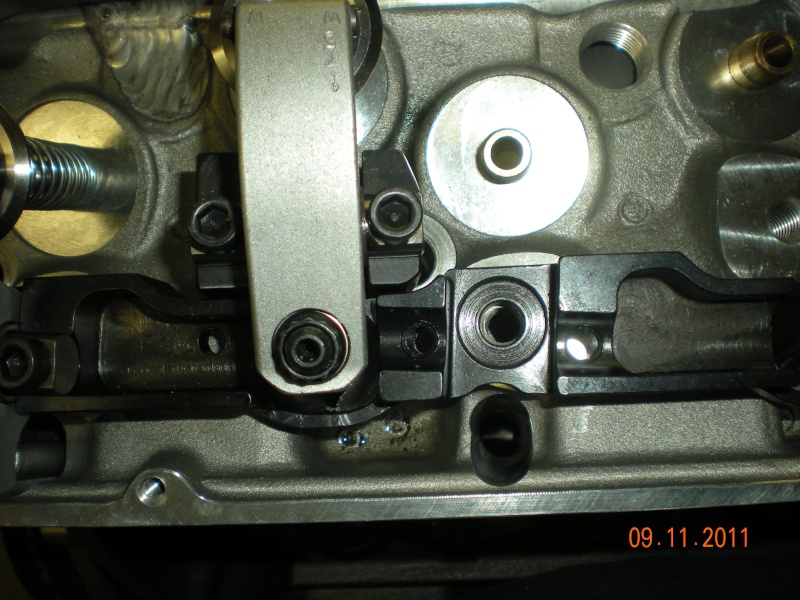

just to add to this post some info on how these rockers fit on eliminator heads.i had to slot the holes for big push rods and a little on the corner of the intake stud pads for stand clearance.looken like all will work well! thanks Charlie

lookin good...but what is the weld for?

blem head.got a hellofa deal on them tho!lol. i think the ex bolt hole got drilled little deep.IDT repaired it before i got them.138 wrote:lookin good...but what is the weld for?
